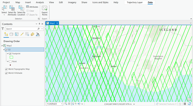

Create a trajectory layer
A trajectory layer can be created from trajectory files or an existing trajectory dataset using the Make Trajectory Layer tool. The composite layer includes a polygon feature layer that displays the trajectory footprints and a read-only point feature layer that displays the trajectory measurement points for each file. Each trajectory in a layer references a dense set of measurement points. The point sublayer is turned off by default to avoid unnecessary drawing.
The point sublayer supports basic symbology, selection, or query of a feature layer. You can also export points to a point feature class using the Export Points tool, located under the Data tab.
Trajectory layer

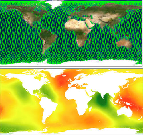

Trajectory datasets contain series of multitemporal points that can be analyzed using geoprocessing tools that work with point feature classes. These points can also be interpolated into a raster surface using the Optimal Interpolation tool or a multidimensional raster surface using the Interpolate from Spatiotemporal Points tool. With ArcGIS Image Analyst, you can use tools in the Multidimensional Analysis toolset to visualize and analyze the interpolated data.
Trajectory dataset interpolation
Mean sea surface elevation is interpolated from Sentinel-3 SRAL data.

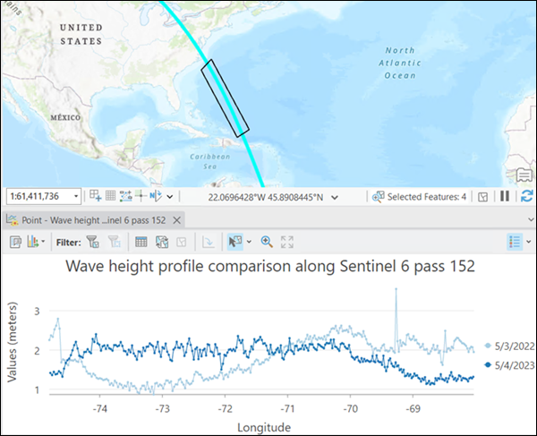

Trajectory data can also be analyzed and visualized using the trajectory profile chart.
Trajectory wave height profile
A trajectory profile shows wave height differences along selected repeating tracks.
