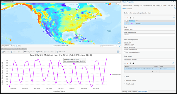

    1. One or more variables—This option works on most multidimensional mosaic datasets. It is typically used when the variables in the mosaic dataset are single band, and they have only a time dimension. You can select one or more variables from the variable name list and compare them in the same temporal profile. Once the variable name is selected, the corresponding graph is displayed on the temporal profile.
      If multiple variables are selected and their value ranges vary widely, check the Standardized values option in the Axes category to put all the variables on the same scale, allowing multiple distributions to be visualized in the same chart. For example, you may want to visualize precipitation that is within a couple of inches per day, and the daily average temperature in Fahrenheit, such as 60–90 degrees, together. Standardization of the values on y-axis involves a z-transform where the mean for all values is subtracted from each value and divided by the standard deviation for all the values.
      Temporal profile chart for one or more variables.

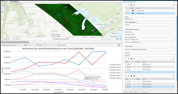

    2. One variable with multiple bands—Specify the bands that you want to plot on the temporal profile; each band will have a separate graph. First, select one variable, then add the bands using their band names. You can also use the Add all or Remove all button to add or remove all bands, respectively. Comparing the values of a specific band at multiple locations is also allowed on the temporal profile.
      Sometimes the mosaic dataset contains multiband images in time series, for example, multispectral satellite measurements with an Acquisition time field. You can also create a multidimensional mosaic dataset using the composite bands template, which creates a mosaic dataset containing multiband imagery. See Create a mosaic dataset using a Multiband Composite template for more details.
      Temporal profile chart for one variable with multiple bands.

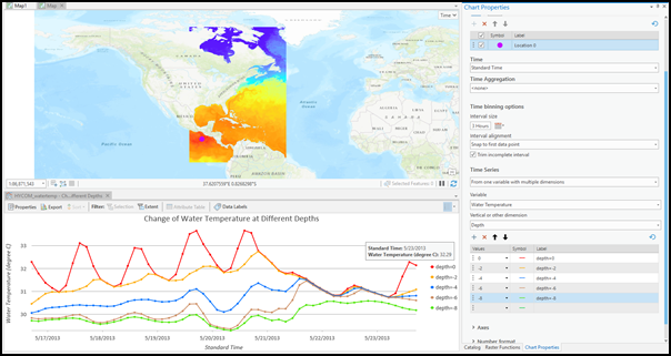

    3. One variable with multi-dimensions—This option works on a multidimensional mosaic dataset containing a time dimension and other dimensions. Select the time variable name and the other dimension name, and make the temporal profile for your variable based on values from the other dimension; each value of the other dimension will have a separate graph. For example, some ocean salinity data comes with both time and depth dimensions—you can make a temporal profile for salinity at depth one, depth two, and so on. Comparing variables at the specific values of other dimensions at multiple locations is also allowed in the temporal profile. Use the Add all or Remove all button to add or remove all values of the other dimension.
      Temporal profile chart for one variable with multiple dimensions.
