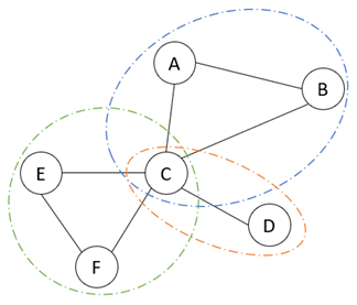

Biconnected
The Biconnected method finds communities in the network that are connected to each other. Two entities connected by a relationship are part of the same community. Other entities belong to the same community if relationships allow you to go from one entity to another, and if this remains true after removing one of the relationships in the community. Each entity can belong to many communities.
Link chart with three interconnected communities
In this example, C is part of all three communities since it has a relationship to entities in each community. The entities A, B, and C form one community because they are each connected to each other, and they remain connected to each other when one of the relationships between them is removed. When the relationship between C and D, or C and E, or C and F is removed, D, E, and F, respectively, are no longer connected to A and B, so they are not part of the A, B, and C community.

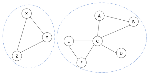

Weakly Connected
A weakly connected community is one in which all entities are connected to each other by a path. The direction of relationships between entities in the link chart is not considered; that is, the link chart is evaluated as an undirected graph.
Link chart with two weakly connected communities
In this example, there are two weakly connected communities. A, B, C, D, E, and F form one community and X, Y, and Z form another community. Each of these communities have relationships that connect all entities. There are no relationships that connect the X, Y, Z community to the A, B, C, D, E, F community.
If every entity in the graph is connected to every other entity in some manner, the entire graph is weakly connected.

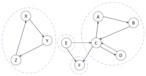

Strongly Connected
A strongly connected community is one where all entities in the community are connected to each other when a relationship's direction is considered. That is, the link chart is evaluated as a directed graph.
This means that if you start anywhere in the community and trace a path that respects each relationship's direction, you can reach all entities in the community.
Link chart with some strongly connected communities
In this example, the X, Y, Z community and the A, B, C, D community are strongly connected because you can start at any entity in either community and follow the directed relationships to reach every other entity.
E and F are their own communities since they are not strongly connected to any other entities. You can reach F from the A, B, C, D community, but you cannot reach the larger community from F. Similarly, you can reach the A, B, C, D community from E, but you can't reach E from the larger community.

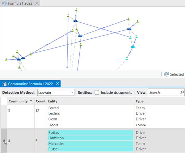

Open the Community table
Communities for the entities in a link chart are determined using the Louvain method by default and described in the Community table . Use the Detection Method drop-down list to evaluate communities using another method instead. All rows in the table will be updated to display properties of the new community results.
The table has one row for each community. Properties of each community are shown in different fields in the table:
  • Solution—Displayed for the Label Propagation method only when the Show solution column option is checked; the option is checked by default. This field provides an identifier for each solution produced by the Label Propagation method.
  • Community—For all community detection methods except Label Propagation, this field shows an identifier for the community and is used by default to sort rows in the table. For the Label Propagation method, this column displays a value that identifies a community in one solution produced by this method.
  • Count—The number of entities in the community.
  • Entity—The display name for each entity in the community. The first five entities are listed by default. If the community includes more than five entities, you can show additional entities by clicking More at the bottom of the list. Click Less to show fewer entities.
  • Type—The entity type for each entity in the community. Types of the first five entities are listed by default. When more entities are shown in the list, their corresponding entity types are also listed in the Type column. Click More at the bottom of the Type list to show additional entity types. Click Less to show fewer entity types.

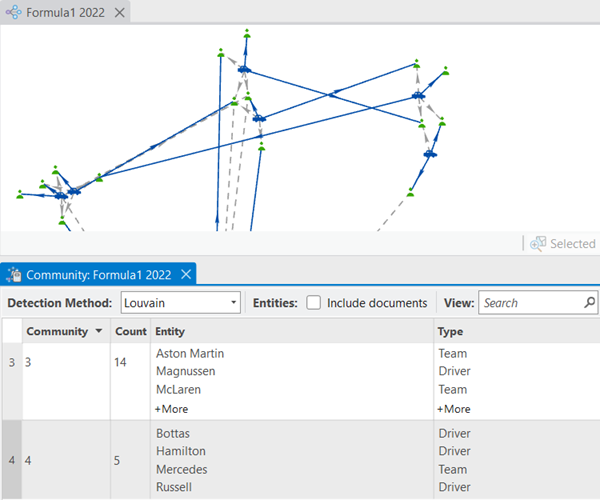

To view communities for the entities in a link chart, complete the following steps:
  1. On the Link Chart tab on the ribbon, in the Analyze group, click Community .
    The Community table opens. The name that appears on the tab for the Community table view identifies the link chart for which the communities were calculated. The Louvain method is used by default. Rows in the table are sorted using the Community field by default.
    The Community table describes groups of closely related entities in the link chart.
  2. Click the Detection Method drop-down list and click another method for evaluating communities.
    Communities in the link chart are reevaluated and the rows in the table are updated to represent the results.
Include documents
By default, Document entities are not considered when communities are detected even if they are present in the link chart; however, you can include Document entities in the calculations. For example, you can determine whether the documents connected to certain entities also belong to those communities.
  1. Check or uncheck the Include Documents check box on the toolbar at the top of the Community table.
    • Checked—Include Document entities when detecting communities. Documents will be considered and included in their respective communities based on the chosen method.
    • Unchecked—Exclude Document entities when detecting communities. Documents will not be considered or included in communities. This is the default setting.
The Community table is automatically updated to reflect the changes to this setting. Document entities are added to or removed from the table and communities are recalculated automatically.
Identify communities in the link chart

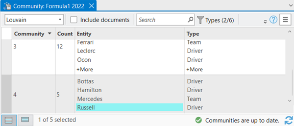

When you select one or more rows in the Community table, all entities in the communities defined by those rows are selected in the Entity field in the table and in the associated link chart. Click the row number or values in the Community, Count, or Solution fields to select a row in the table.
You can click one or more individual entities in the Entity field to select it. Similarly, if you select an entity in the link chart, it is selected in the Entity field in the corresponding Community table. With the Label Propagation detection method, an entity can appear in more than one row in the Community table and is selected in all rows in which it appears.
You can click an entity type in the Type field to select all entities of that type in the community.
  1. Click a row in the Community table to select the entities in that community.
    The corresponding entities are selected in the Entity field and in the link chart.
    Entities in the community are selected in the Community table and in the link chart.
  2. Click a type in the Type field to select all entities of that type in a community.
    Entities in the community of the specified type are selected in the Community table and in the link chart.
  3. Click an entity in the Entity field to select it.
    The entity is selected in the Entity field and in the link chart.
    The specific entity is selected in the Community table and in the link chart.
  4. Click More at the bottom of the list of entities in the Entity field or at the bottom of the list of types in the Type field to see all entities and types in a community.
  5. Click Less at the bottom of the list of entities in the Entity field or at the bottom of the list of types in the Type field to see fewer entities and types in a community.

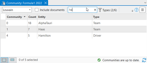

Search the Community table for an entity
It may not be obvious which community includes an entity of interest. You can search for an entity to select it in the Community table view.
  1. Click in the search text box on the toolbar at the top of the Community table.
  2. Type the display name of an entity in the link chart.
    The rows in the Community table are automatically filtered to show only the entities whose display name matches the name you typed. Only rows representing the filtered entities are displayed in the table.
    Type an entity's display name in the search text box to search for the entity in the Community table.
  3. Select the community containing the entity in which you are interested.
  4. Click the Delete button in the search text box to clear the search and see all rows in the Community table.
    All entities in the community are visible and remain selected. All communities are visible in the table.
