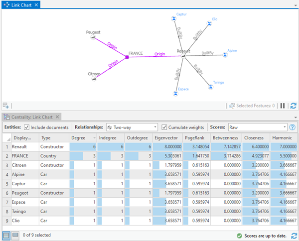

Measures of centrality
For link charts based on a knowledge graph, six measures of centrality are calculated: Degree, Eigenvector, PageRank, Betweenness, Closeness, and Harmonic. These calculations are all presented in different fields in the link chart's Centrality table.
The Degree, Eigenvector, and PageRank scores are calculated based on the number of relationships in which an entity participates. The Betweenness, Closeness, and Harmonic scores are calculated based on the length of the path from an entity to all the other entities in the link chart.
All relationships in a knowledge graph have an inherent direction in the way they are defined, from the origin entity to the destination entity. However, by default, centrality scores for a link chart are calculated in a manner that ignores a relationship's direction. You can calculate the scores in a manner that accounts for the direction of the relationship, and also with the inherent direction of relationships reversed. An entity's centrality score can be different when relationship directions are considered.
Entity groups are represented in the Centrality table as a single row, and the centrality score is calculated for the group. In contrast, relationships are considered individually even if they are grouped as determined by the Cumulate importance for parallel relationships option.
Degree centrality
The Degree centrality score is defined as the total number of link chart relationships in which an entity participates. The Degree score is useful in determining entities that are central to the graph. For example, when the link chart portrays a social network a Person entity with a high Degree score is one that has many connections to other Person entities, and therefore is more central to the network.
When relationship direction is accounted for, the overall Degree score can be broken down to reflect an entity's Indegree and Outdegree. The Indegree score reflects the number of relationships that are incoming—where an entity is at the destination of a relationship. The Outdegree score reflects the number of relationships that are outgoing—where an entity is at the origin of the relationship. When a Person has a high Outdegree score, they may be more crucial with respect to disseminating information. When a Person has a high Indegree score, they are more likely to receive information from different sources.
Recursive relationships occur when an entity is both the origin and the destination of the relationship; these relationships are counted when calculating the Degree of an entity. If an entity participates in only one relationship that is recursive, it has a Degree of two, an Indegree of one, and an Outdegree of one.
These centrality scores are displayed in the Degree, Indegree, and Outdegree fields in the Centrality table.

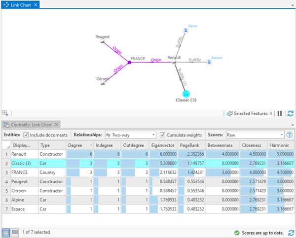

Open the Centrality table
Centrality scores for the entities in a link chart are provided in a Centrality table . The table has one row for each entity. Fields in the table show an entity's display name, its entity type, and the score calculated for each measure of centrality.
In a field that displays a centrality score, each cell in the table has a dynamic blue histogram bar representing the entity's score relative to other entities in the link chart. The length of the bar is proportional to the maximum score in that field.
You can interact with the Centrality table in the same manner as you interact with attribute tables associated with the feature layers in a map. For example, you can click the heading of a field to sort the rows in the table using the values in that field. Sorting the Centrality table using a field containing centrality scores allows you to visualize the histogram of values for that centrality measure.
You can click one or more rows in the Centrality table to select them, and the corresponding entities on the link chart are selected. Similarly, selecting entities on the link chart will select the corresponding rows in the table.
View centrality scores for the entities in a link chart by opening its Centrality table, and explore the table's contents following the steps below:
  1. On the Link Chart tab on the ribbon, in the Analyze group, click Centrality Centrality
    The Centrality table opens. The name that appears on the tab for the Centrality table view identifies the link chart for which the centrality scores were calculated. Rows in the table are sorted using the value in the Degree field by default.
    A link chart's Centrality table describes which entities are most important for the graph depicted by the link chart.
  2. Click a row in the Centrality table to select it.
    The corresponding entity or entity group is selected on the link chart.
    Selected row in the Centrality table and the corresponding entity on the link chart
