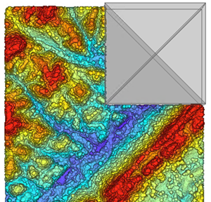

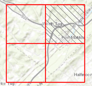

Missing LAS files
If any LAS related files that are referenced by the LAS dataset are moved, renamed, or deleted the path stored in the LAS dataset will be broken and they will only show extent boxes with special symbology for the missing files. In 2D, missing files display using a gray hatch symbol. In 3D, they display using a gray box. The graphics below show examples, in 2D and 3D, of a LAS dataset that references four LAS files with one that is missing.
Missing LAS file in a map view Missing LAS file in a 3D scene
