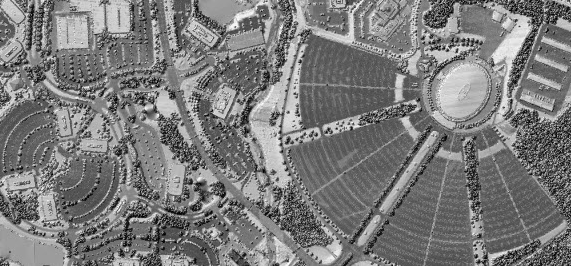

If the lidar data includes intensity values, you can make images from them that look similar to black-and-white aerial photos. Using ArcGIS Pro, you can create intensity imagery from lidar data.
Intensity image
This is an intensity image example in ArcGIS Pro.
