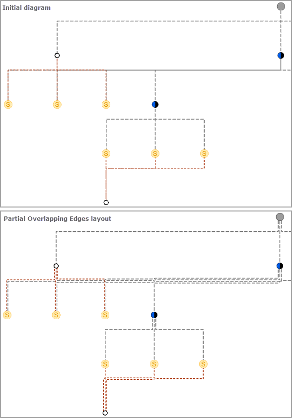

is a refinement layout algorithm that processes edges. It applies to any type of diagram.
This layout algorithm detects sets of collinear edges or collinear portions of edges (edge segments) that can be considered inside a buffer zone of a given size.
The edges or segments must be relatively close to each other—more or less parallel, overlap, or nearly overlap—and similar in length. Segment buffer zones are then repositioned equally on the left and right sides, a proportional distance from the middle of the zone.
The distance between each segment is equal to a given offset. If vertices exist along diagram edges, the global orientation of the segments is preserved as much as possible. This is done so that, for example, a segment lying on the left side of another segment still ends up on the left side.
The images below show a sample diagram before and after applying the Partial Overlapping Edges layout:

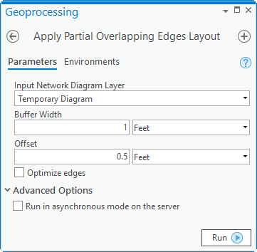

To apply the Partial Overlapping Edges layout on an active diagram map view, do one of the following:
On the Network Diagram tab, click the drop-down arrow on the Diagram Layouts button in the Layout group, and click the Partial Overlapping Edges
layout item in the gallery.Load the Apply Partial Overlapping Edges Layout tool in the Geoprocessing pane, adjust the Partial Overlapping Edges layout parameters and click Run.
The sections below clarify the main Partial Overlapping Edges diagram layout parameters.
Buffer Width
This parameter is used to specify the width of the buffer zone in which to search for collinear edge segments.
In the images below, the gray edge at the right is initially at a distance of 20 feet from the green edge. With 10 feet for the buffer parameter, the algorithm doesn't consider this edge as part of the same set of collinear edges, such as all the other edges. With 35 feet for the buffer parameter, it is included in the process:

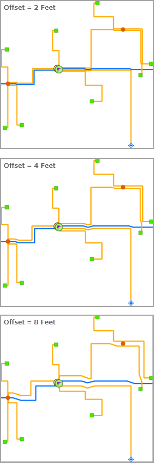

Offset
This parameter is used to set the distance that will separate the detected edge segments:
