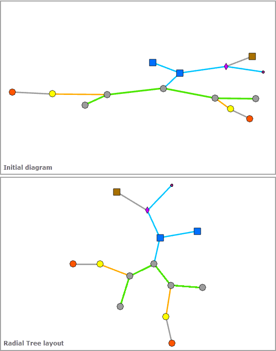

The images below show a sample diagram before and after applying the Radial Tree layout:
Sample diagram before and after applying the Radial Tree layout

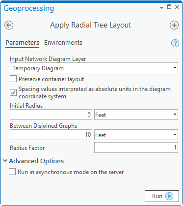

To apply the Radial Tree layout on an active diagram map view, do one of the following:
  • On the Network Diagram tab, click the drop-down arrow on the Diagram Layouts button in the Layout group, and click the Radial Tree layout item in the gallery.
  • Load the Apply Radial Tree Layout tool in the Geoprocessing pane, adjust the Radial Tree layout parameters and click Run..

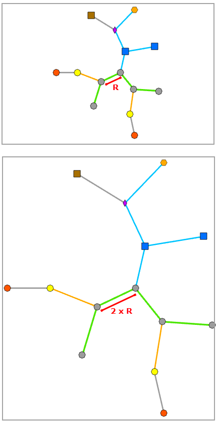

Initial Radius
This parameter sets the radius of the first concentric circle whose center is the radial tree root junction, that is, the radius of the circle around which the diagram junctions belonging to the first hierarchical level are placed. This corresponds to the R spacing below:

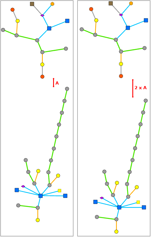

Between Disjoined Graphs
This parameter is used to fix the minimum spacing that must separate features belonging to disjoined graphs when the diagram contains such graphs, that is, the A spacing below:

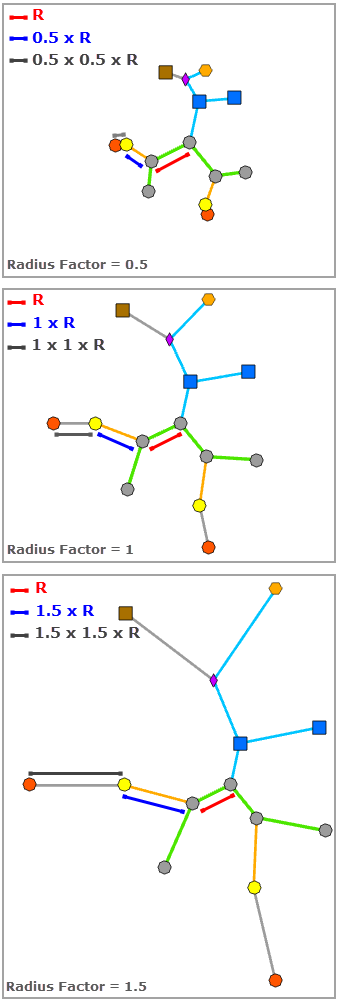

Radius Factor
This parameter value is the multiplicative factor used to increase or decrease the radius of each concentric circle. It is also the distance that separates each concentric circle related to a hierarchical level. When using a radius factor less than 1, the distance that separates the diagram junctions belonging to the (n) hierarchical level and the (n+1) hierarchical level progressively decreases. With a factor greater than 1, the distance between the hierarchical levels increases progressively. The images below show how the red, blue, and gray spacings vary according to three values, Radius Factor = 0.5, 1, and 1.5.
