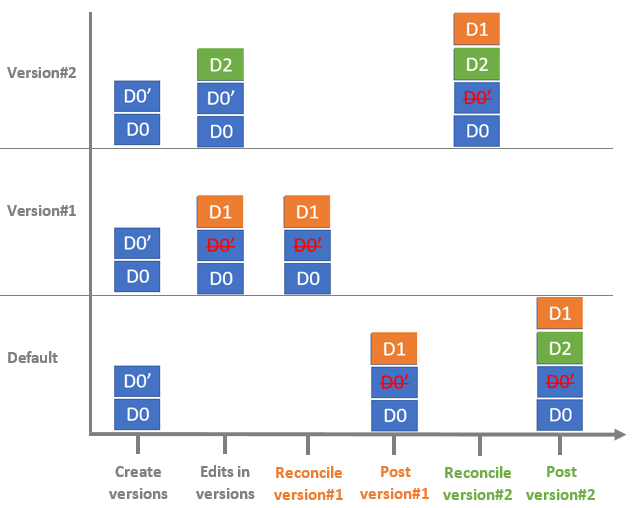

There is no conflict management when reconciling network diagrams with the default version. All diagrams existing in the default and edited versions since the version was created are merged in the reconciled version.
The network diagram reconcile process follows the rules below:
  • When a default diagram is deleted, it is also deleted in the reconciled version. For example, in the image below, when reconciling Version#2, the D0' diagram deleted in Default is also deleted in Version#2.
  • A new diagram in the default version becomes a new diagram in the reconciled version. When reconciling Version#2, as shown below, the new D1 diagram in Default becomes a new diagram in Version#2.

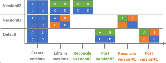

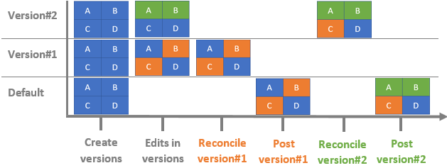

  • For a diagram that exists in both the edited and default versions, the diagram content is merged as follows:
    • A diagram feature newly added to the default version is added to the reconciled diagram.
    • A diagram feature newly added to the edited version is persisted in the reconciled diagram.
    • A diagram feature edited in the default version is merged with the reconciled diagram.
    • A diagram feature edited in the edited version is persisted in the reconciled diagram whether or not it has been edited in the default version. In other words, when there is a conflict with a diagram feature in the default and reconciled versions, it is always resolved in favor of the reconciled version.
      For example, imagine the content of the D0 diagram above as a composition of four sets of diagram features—A, B, C, and D. As shown in the image below, diagram features in A and B are edited in Version#2, while diagram features in B and C are edited in Version#1. After posting either of these versions to the default version, you reconcile the second version. The result in the second reconciled version is as follows:
      • Since there are no conflicts with A and C, the D0 diagram merges edits from the two versions to the first posted version.
      • Since there are conflicts with B, the edits in the version reconciled last are persisted.
      Diagram edits are merged after reconciling and posting Version#2 last
      Diagram edits are merged after reconciling and posting Version#1 last

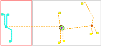

The sample diagram is edited in Version A; some diagram features at the left are moved aside. This causes the diagram extent to increase, with the additional red extent portion shown below.
The default version reflects this change once Version A is posted,
Sample diagram of the default version after posting Version A

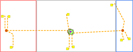

Diagram in Version B before reconcile
The sample diagram is edited in Version B; some diagram features at the right are moved aside. This causes the diagram extent to increase, with the additional blue extent portion shown below.
Sample diagram in Version B before reconcile

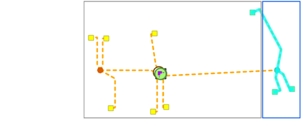

Diagram in Version B after reconcile
The image below shows the diagram after Version B is reconciled. Edits on diagram features on the left side, from default version, are now included in the diagram, but the current diagram extent didn't increase to fit the new diagram extent. The additional red extent portion is outside the current diagram extent.
Sample diagram in Version B after reconcile
