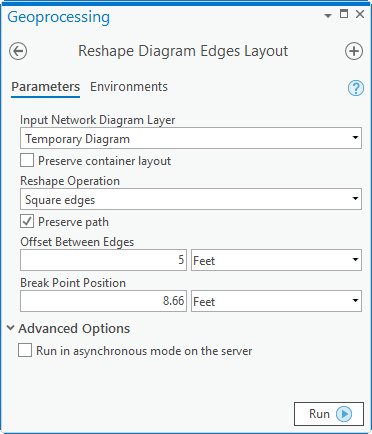

Reshape operation = Square edges
When running the Reshape Diagram Edges layout with Reshape operation set to Square edges, vertices are placed along diagram edges so they display with right angles.
Apply Reshape Diagram Edges Layout parameters for Reshape Operation = Square edges

Preserve path
This parameter specifies whether vertices along the edges that are going to be squared will be preserved. When this option is enabled, the direction of any edge will be considered and vertices along that edge will be preserved, from the first vertex to the last.
Square edges—Preserve path

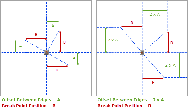

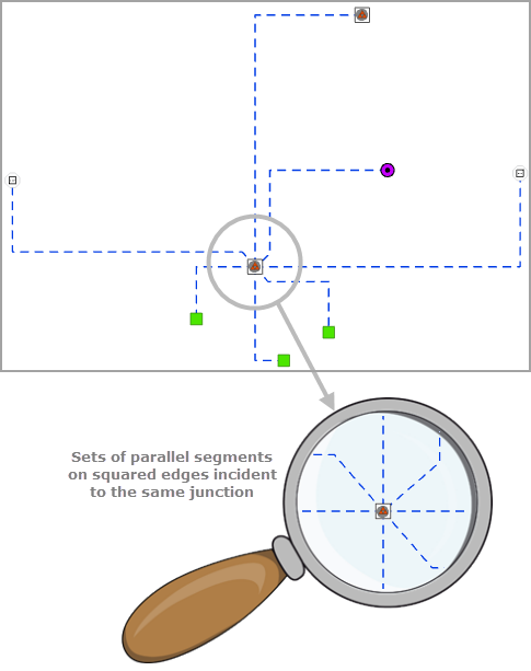

Offset Between Edges and Break Point Position
Offset Between Edges is used to set the spacing that will separate parallel segments of squared edges incident to the same junction; that is, the A green spacing in the image below.
Break Point Position allows to set the maximum distance between each junction to the first or last break point along edges incident to that junction when those edges are squared; that is the B burgundy distance in the image below:
Square edges—Sets of parallel segments on squared edges incident to the same junction
Square edges—Offset Between Edges and Break Point Position parameters

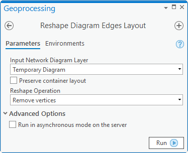

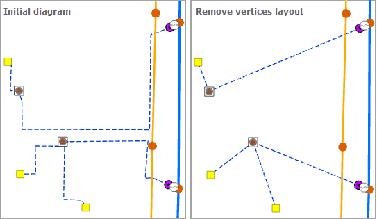

Reshape operation = Remove vertices
When running the Reshape Diagram Edges layout with Reshape operation set to Remove vertices, all vertices along any edges in the diagram are removed.
Reshape Diagram Edges layout parameters for Reshape Operation = Remove vertices
The images below show a diagram sample before and after applying the Reshape Diagram Edges layout with the Remove vertices operation:
Sample diagram before and after applying the Reshape Diagram Edges layout with the Remove vertices operation

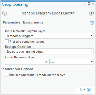

Reshape operation = Separate overlapping edges
When running the Reshape Diagram Edges layout with Reshape operation set to Separate overlapping edges, all edges that connect the same origin and extremity junctions are separated where they were overlapping.
Reshape Diagram Edges layout parameters for Reshape Operation = Separate overlapping edges
This parameter specifies the absolute spacing that separates two edges that were overlapping after the layout completes:
Separate overlapping edges—Offset Between Edges

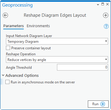

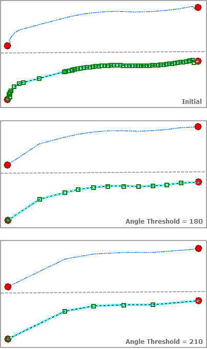

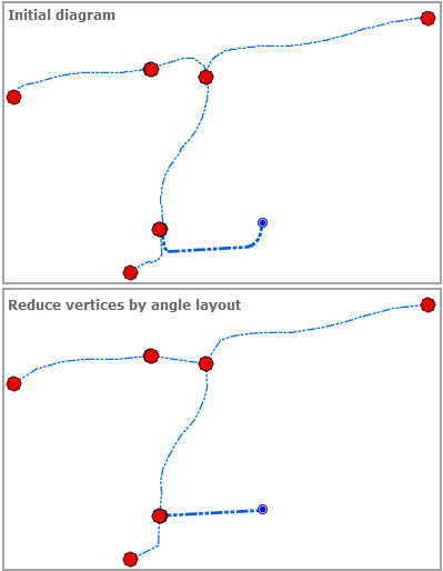

Reshape operation = Reduce vertices by angle
When running the Reshape Diagram Edges layout with Reshape operation set to Reduce vertices by angle, some or all vertices displayed along diagram edges are reduced according to the angle that separates the segments incident to those vertices.
Reshape Diagram Edges layout parameters for Reshape Operation = Reduce vertices by angle
The images below show a diagram sample before and after applying the Reshape Diagram Edges layout with the Reduce vertices by angle operation:
Sample diagram before and after applying the Reshape Diagram Edges layout with the Reduce vertices by angle operation
Angle Threshold
This parameter specifies the angle formed by the incident segments over which the vertex related to these segments is reduced. The wider the angle, the fewer vertices are reduced.
Reduce vertices by angle—Angle Threshold

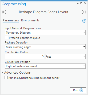

Reshape operation = Mark crossing edges
When running the Reshape Diagram Edges layout with Reshape operation set to Mark crossing edges, horizontal and vertical diagram edges that cross each other at a right angle in the diagram will be marked and the geometry of one of the crossing edges will be reshaped to display a circular arc at this location.
Reshape Diagram Edges layout parameters for Reshape Operation = Mark crossing edges
The images below show a diagram sample before and after applying the Reshape Diagram Edges layout with the Separate overlapping edges operation:
Sample diagram before applying the Reshape Diagram Edges layout with the Mark crossing edges operation
Circular Arc Radius
This parameters is used to set the radius of the circular arc that is added at the crossing edge locations:
Mark crossing edges—Circular Arc Radius
