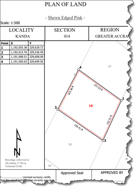

A parcel layout or title map layout is a depiction of a single parcel that is described according to local regulations. A parcel layout or title map can display the following:
  • A graphic of a single parcel with sequentially labeled lines or corner points
  • Owner names
  • Registration details
  • A parcel identification number
  • A table listing x,y coordinates for each sequentially labeled point
  • A table listing dimensions for each sequentially labeled line
  • A table listing curve parameters for each sequentially labeled curve
  • Connection lines or ties from the parcel
  • Related information about the parcel record
  • Related information about the parcel, such as feature-linked annotation
Example of a title map or parcel layout
A title map showing a parcel with sequentially labeled corner points.
