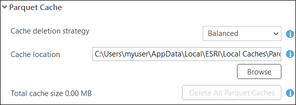

  4. In the Set default options for new maps and scenes panel, scroll to and expand the Parquet Cache section.
    Settings for Parquet caches
    Location and retention rule settings for persistent Parquet caches.
  5. Use the Cache deletion strategy drop-down menu to choose how long Parquet caches are retained.
    • Balanced—This is the default setting. It balances the need to preserve caches to improve performance with the need to maintain available disk space by deleting Parquet cache files larger than 1024 MB that were not accessed in the last 30 days. Cache files smaller than 1024 MB are retained.
    • Preserve caches—Parquet caches will never be automatically deleted. Choose this option if disk space is not a concern and you want to retain the Parquet cache files to maintain performance.
      Tip:
      You still have the option to delete all cache files at any time, as described in step 7.
    • Preserve disk space—Any Parquet cache files that are not accessed in a seven day period will be deleted. Any caches in use in the last seven days will remain in the cache location. Choose this option if local disk space is a concern for the cache location.
  6. Optionally, change where persistent Parquet cache files are stored.
    The default location is C:\Users\<username>\AppData\Local\ESRI\Local Caches\ParquetCacheV1.
    The location must be on disk local to the machine where ArcGIS Pro is installed.
    If you change the location, the new folder must be empty. Do not use this folder to store anything but the Parquet cache files.
  7. To delete all existing Parquet data cache files on the local machine, click Delete All Parquet Caches.
