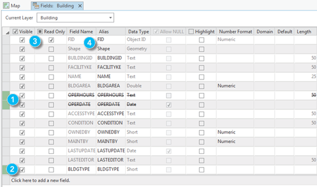

Work with shapefiles in the fields view
You can use the fields view to add or delete fields, view field properties, or modify layer properties for shapefiles. See Use the fields view for more information about the fields view.
Below is an example of some standard editing tasks you can do in the fields view. Here, edits are made to a shapefile layer named Building.
  1. Delete unnecessary fields.
  2. Add a new field named BLDGTYPE.
  3. Change the layer properties of a field: visibility, read-only, or field alias.
  4. Some field properties are read-only and are unavailable, such as Field Name.
Example edits done on a shapefile in the fields view.
