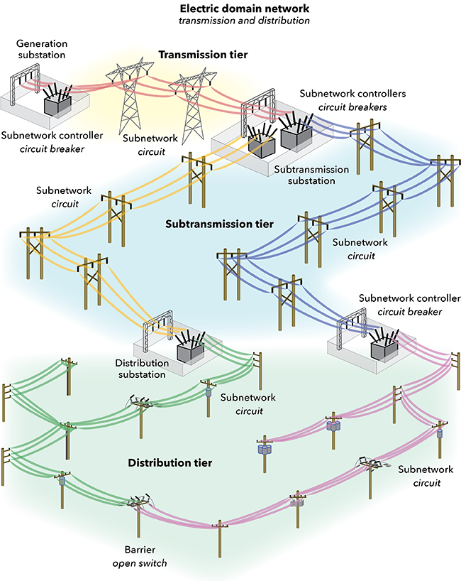

A utility network has a structure that matches how electric, gas, water, and wastewater organizations are organized. The simplified example below shows how an electric utility is organized by voltage levels. The utility network structure includes tiers for common voltage ranges, subnetworks for circuits, and subnetwork controllers for the starting point of each subnetwork. Subnetworks are terminated either at the ends of lines or by barriers that can model the current open or close status of switches and valves.
