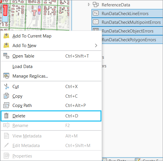

After running multiple run data check configurations, you can delete the error tables once the errors have been addressed. To delete the Run Data Checks tables, complete the following steps:
Caution:
Do not apply this workflow to the four GDB_Validation<tableName>Errors tables if you use validation attribute rules. This workflow is strictly for Run Data Checks results for the RunDataCheck<TableName>Errors tables.
  1. In the Catalog pane, press the Ctrl key and select the RunDataCheckLineErrors, RunDataCheckMultipointErrors, RunDataCheckObjectErrors, and RunDataCheckPolygonErrors error tables.
  2. Right-click any of the selected tables and click Delete .
    Delete Run Data Checks error tables
    The tables are removed from the Catalog pane and deleted from the project's default geodatabase.
