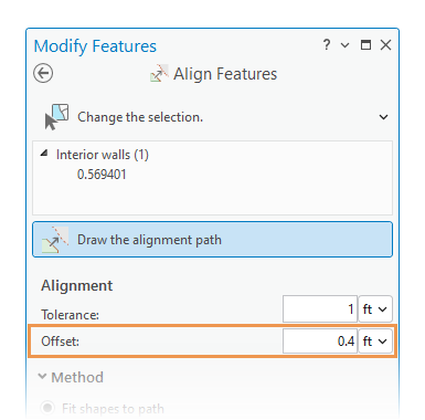

  7. Type a buffer distance in the Tolerance box, and choose a unit format.
    The tolerance buffer displays in real time, allowing you to evaluate and change this setting. Feature geometry within the specified tolerance is modified.
  8. Type an offset distance in the Offset box, and choose a unit format.
    Note:
    This parameter is only available with an ArcGIS Indoors license. It is commonly used to align wall thickness or other features at a specified distance from the alignment path.
    Offset
    To learn more, see Generate floor plans from point clouds.
