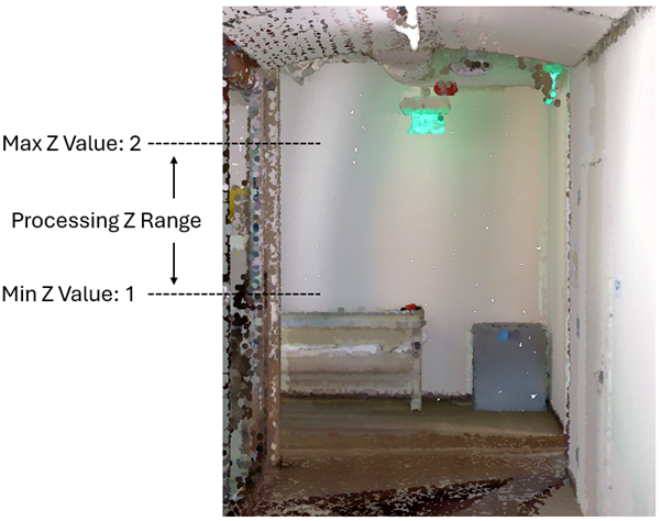

  12. Optionally, specify z-values for the Z Ranges parameter.
    By specifying one or more processing z-ranges, you can generate lines for a specific floor of a multifloor point cloud, and reduce artifacts caused by furniture, light fixtures, and other objects captured in the point cloud data. You can determine desired z-values by examining the point cloud data in a scene in ArcGIS Pro and use the Explore tool to find the z-values on a floor that are above furniture features and below ceiling fixtures.
    Room with furniture and ceiling fixtures and z-range values
    A minimum z-value of 1 and a maximum z-value of 2 are set to avoid capturing furniture and ceiling fixtures in a room.
