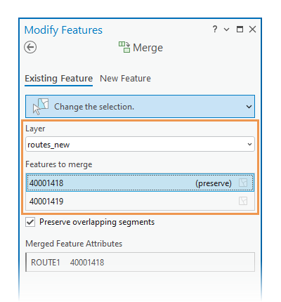

  4. Click the Existing Feature tab.
  5. Click the Select two or more features tool , and select the features you are merging.
    If features are currently selected, the selection tool displays Change the selection.
    Tip:
    For steps to change the field that uniquely names a feature in the Features to merge section, see Set the layer display field.
    The selected features appear in the Features to merge section, and their origin layers appear in the Layer drop-down list.
  6. Click the Layer drop-down arrow and choose the layer containing the features you are merging.
    If all selected features are on the same layer, only one layer is available.
    To remove a feature from the selection, hover over the feature in the Features to merge section and click Unselect .
    Merge Existing Feature
    The selected features appear in the Features to merge section.
