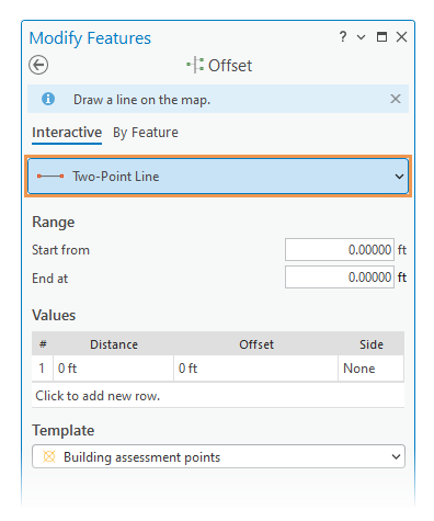

  3. Check the Preview check box at the bottom of the pane to display a preview of the construction line.
  4. To draw or trace a temporary construction line, click the Interactive tab, click the tool drop-down menu, and choose a feature construction tool.
    Interactive tab
    Two-Point Line 2-Point Line
    Click the map, move the pointer to draw the line, and click the map again.
    Trace Line Trace
    Click the feature along which you want to trace a line and move the pointer along the feature. Click the feature where you want to end the line, and click Finish .
    Tip:
    Press T to show the vertices of the feature you are tracing.
  5. To select an existing line feature, click the By Feature tab, and select the feature.
    The Select one line feature tool automatically runs.
  6. In the Range section, type the measured distances from the start of the line for the first and last stations. These values are usually available on the recorded survey document.
    1. In the Start from text box, type the distance for the first station, and press the Enter key.
    2. In the End at text box, type the distance for the last station and press the Enter key.
      The default end distance that is automatically generated is optional. You can delete this value if the end distance is unknown.
