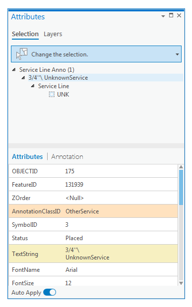

  2. On the ribbon Edit tab, click Attributes in the Selection group.
    The Attributes pane appears.
  3. Click the Select tool and select the annotation feature.
    The selection list appears in the pane.
    Tip:
    To filter the selection, right-click a feature in the pane selection tree view, and click Unselect or Only Select This .
  4. Click the Attributes tab.
  5. Click the feature in the selection tree view whose attributes you are editing.
    Tip:
    To edit a field that is common to several features, press the Ctrl key while clicking the features in the selection tree view.
    The attributes for the selected feature appear on the Attributes tab.
    Attributes tab
  6. To edit the text string that displays as text in a map, click the TextString field and type the text.
  7. To edit editable symbol display properties, click the corresponding field and type the value.

  8. To apply the changes, press Enter or click another field.
    If Auto Apply is turned off, click the Apply button.
