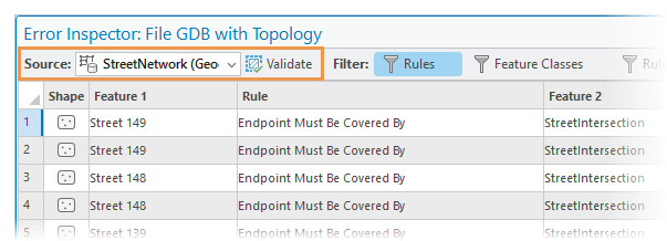

  2. On the menu bar, in the Source group, choose a source topology and validate it.
    Error Inspector Validate
    1. Click the Source drop-down arrow and choose a topology.
    2. Click Validate .

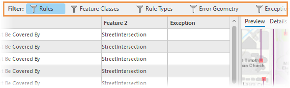

  3. In the Filter group, choose the rules, errors, exceptions, rule types, error geometry, and map extent displayed in the table view.
    Filter settings work together using Boolean AND logic. They collectively display information only if each of the filters return a result. If any of the filter settings return zero results, the table displays nothing.
    Filters with enabled filter settings are highlighted blue.
    Error Inspector Filter

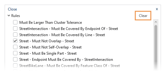

    1. Click Rules , check the check boxes on the pop-up menu for the rules you want to show in the table, and click Close .
      To uncheck all check boxes, click Clear.

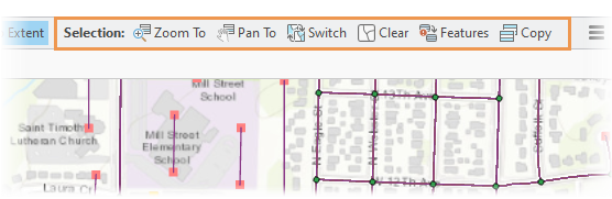

  5. To zoom or pan to selected records, use the following commands in the Selection group.
    Error Inspector Selection
    Zoom To Selection Zoom To Selection
    Zoom in and center the map on the extent of the errors in the selected rows. Alternatively, press Ctrl+Shift+Equal sign.
    Pan To Selection Pan To Selection
    Center the map around the errors in the selected rows. Alternatively, press Ctrl+Shift+N.
    Switch Selection Switch Selection
    Deselect all the selected features and select all the deselected ones. Alternatively, press Ctrl+U.
    Clear Selection Clear Selected
    Deselect all selected rows. Alternatively, press Ctrl+U. To select all rows, press Ctrl+A
    Select Features Features
    Select the features that created the errors in the selected rows. Alternatively, press F.
    Copy Copy
    Copy selected rows and column headers as tab-separated data to the clipboard. Exceptions are copied as True or False.
    Tip:
    You can paste this data to external applications such as Microsoft Excel.

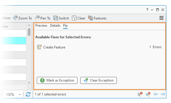

  8. Click the Fix tab and use the available tools to fix the selected error or to mark or clear an exception.
    Error Inspector Error Viewer
    Available Fixes for Selected Errors
    This section contains tools with defined fixes for a specific error. If a predefined fix is not available, select and edit the features using standard editing tools.
    Mark as Exception Mark as Exception
    Click this command to remove the highlighted error from the topology layers, and ignore it when topology is validated. You can reinstate the error if you decide the feature needs to comply with the topology rule.
    Clear Exception Clear Exception
    Click this command to reinstate the highlighted error and symbolize it on the topology layers.
