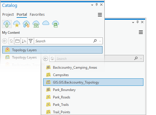

  1. Click the Portal tab in the Catalog pane.
  2. Locate and double-click the topology web feature layer to list the topology and its associated layers.
    Topology web feature layer
  3. Right-click the topology feature layer and click Add To New Map or add the topology to the current map.

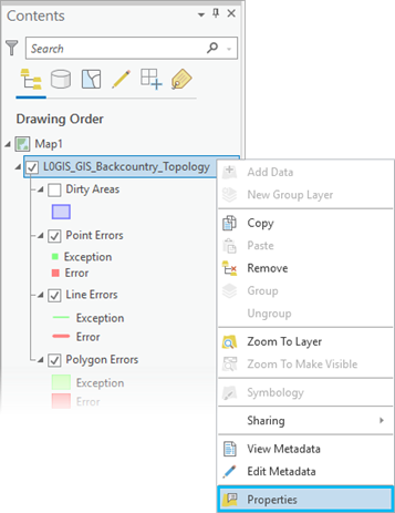

  1. Add the topology and its associated layers to the map.
  2. Right-click the topology layer in the Contents pane and click Properties, or double-click the topology layer name.

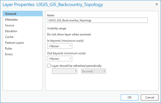

    Accessing the properties of a topology published as a web feature layer
    This opens the topology feature layer's properties.
    General tab in the topology feature layer properties
    Some of the key tabs listed on the Layer Properties dialog box for the topology web feature layer include the Feature Layers, Rules, and Errors tabs. These tabs are described in more detail in the sections below.

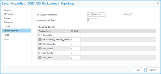

Feature Layers tab
The Feature Layers tab contains the following information:
  • XY cluster tolerance used in the topological processing operations
  • Number of x,y ranks in the topology
  • List of all feature layers associated with the topology feature layer
  • XY rank assigned to each participating feature layer
Feature Layers tab in the topology feature layer properties
Before publishing the topology, when the topology is initially created, you rank the feature classes in the topology to control how vertices are moved when they fall within the cluster tolerance of one another. Feature classes with a rank of 1 are considered to have the highest accuracy. Coordinate ranks allow you to ensure that reliably placed vertices are the anchor locations toward which less reliable vertices are moved during topology validation. For more information, see Topology in ArcGIS.

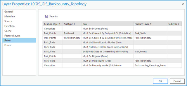

Rules tab
Topology rules define the permissible spatial relationships between features.
Rules tab in the topology feature layer properties
The Rules tab displays the topology rules defined on the feature layers and subtypes participating in the topology feature layer. From the Rules tab, you can save topology rules to a rule set file if needed.

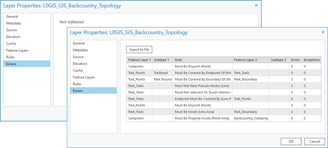

Errors tab
The Errors tab includes a summary of errors and exceptions found in the topology once it is validated. If the topology has not been validated, Not Validated appears on the tab.
Errors tab on the topology feature layer properties shown before and after validating
Similar to the Rules tab, the table shows the topology rules and their participating feature classes and subtypes. The errors and exceptions associated with each topology rule are displayed on the right. Errors are generated when you validate a topology and a topology rule is violated. You can click the Export to file button to save the summary as a text file to create a record of the state of the topology at a given time. This is a useful way to document and monitor progress on a large topology editing project.
