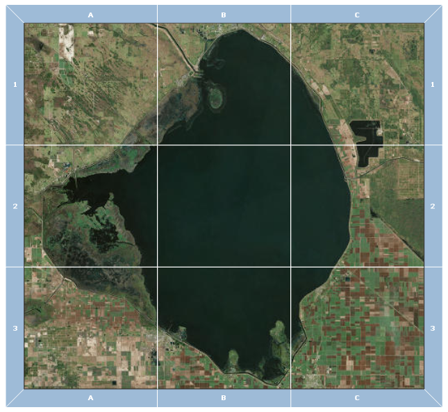

Reference grids, also referred to as grids, are networks of columns and rows used to divide a map into equal-area squares, independent of the map's coordinate system. Each column and row is labeled, allowing every square in the grid to have a unique identifier. Reference grids can be applied to rectangular map frames only since any other shape would result in non-equal-area divisions.
Reference grid example map
