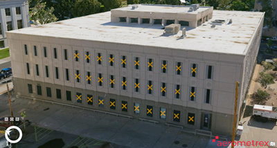

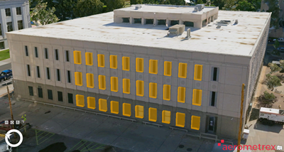

The images below illustrate the object detection result returned with the symbology options available: a box symbology or a location center point X symbol.
