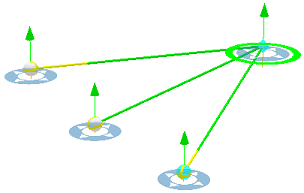

To update the analysis area for an existing line of sight, select the observer or target point in the scene with the Line of Sight tool and use the interactive handles to adjust the location. You can reposition the objects in the x- and y-planes or drag the green arrow to move in the z-plane. A corresponding edit overlay is an optional on-screen display of values that reflect which properties you are updating. You can also type a new value directly in it.
One line of sight observer with three target locations selected for editing
One line of sight observer is shown with three target locations selected for editing.
