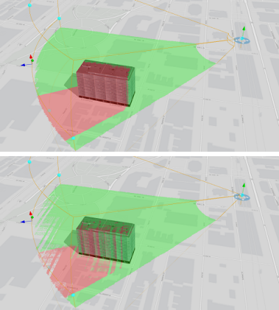

Viewshed accuracy comparison
Viewshed accuracy drops with larger distances and oblique viewing angles.

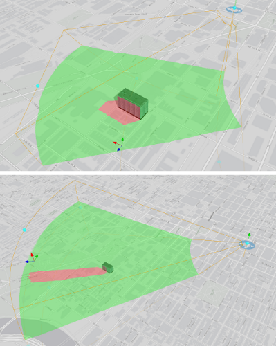

The ratio between the minimum and maximum viewing distances also changes the accuracy of the result. It is recommended that the ratio should remain as low as possible. For example, 10 feet to 600 feet (1:60) would be better than 2 feet to 600 feet (1:300).
Viewshed accuracy comparison for distance ratio
Visual inaccuracies can appear as the viewshed's analysis range ratio increases. (1:60 on top, 1:300 on bottom)
