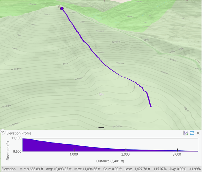

To limit the impact of small obstacles or changes in elevation, increase the Maximum Rise value to allow the path to continue past rises smaller than this value. Once generated, an elevation profile graph of the path is shown in an overlay window.
An interactive steepest path profile graph created in a scene.
