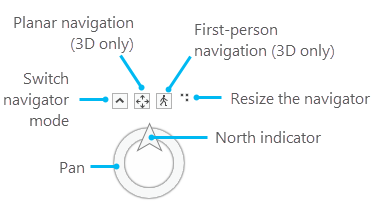

Heading mode
The smaller display state of the on-screen navigator shows the heading as you pan using the ring. Once the panning ring changes color, you can begin panning by dragging in any direction. The closer you are to the center of the navigator, the slower the pan speed. A semitransparent arrow follows your pointer to help indicate direction as you move away from the ring . Click the North button to reset the view back to facing north.
Navigator in heading mode

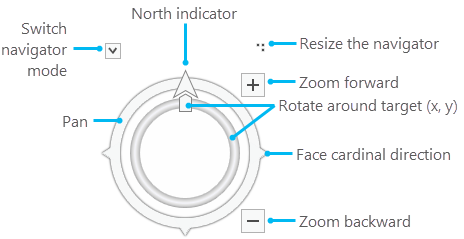

The full-control navigator has a larger set of functions for manipulating the camera. Hover the pointer over the controls to highlight controls you can interact with. The precise camera control gives you a more intuitive navigation experience if you're new to navigating in 3D. Additionally, some GIS data is difficult to navigate, and your workflow may require navigating and editing at the same time. You can achieve this using the navigator and still have access to the pointer for editing feature geometry, since the navigator is touch compatible for touch screen devices.
Full-control navigator in 2D
The full-control navigator capabilities in 2D are shown.

The following table lists the navigator control options and their descriptions:
Navigator control option Description
North indicator Rotate to indicate north direction. Click the arrow to return the view to face north.
Switch navigator mode Change the display view of the navigator to Heading mode (pan and north indicator only) or Full Control mode.
Move up/Move down Specific to 3D, move the camera vertically higher or lower. The camera's x,y and heading are maintained.
Resize the navigator Drag to resize the navigator. Larger sizes may be more suitable for touch screen use. The default size is a customizable property when the navigator opens for new maps and scenes.
Zoom forward/Zoom backward Continuously zoom in closer or farther away from the view. In 3D, the camera's view angle is maintained.
Face cardinal direction The arrows are clickable on the outer ring. Click to rotate the view to face the specific cardinal direction (N/S/E/W).
Pan (Outer ring) Continuously pan the camera horizontally in 2D and 3D. The ring is clickable for short pan movements, or you can click and hold to continuously pan across the view following the direction of the pointer. The speed of the camera is dependent on the distance you drag away from the ring. Hovering the pointer near the center of the navigator slows down the pan speed.
Rotate around target (x,y)—Handle on inner ring Rotate the camera around the center target point. Click and hold to rotate in a motion similar to a dial.
Rotate around target (x,y,z)—Inner ring Specific to 3D, rotation in x,y,z allows the camera to rotate and tilt. The north arrow on the outer ring rotates to act as a directional guide for visual feedback. Click the ring and drag left and right to rotate in x,y around the center target position. Move the ring up or down to tilt the camera. This requires the target to be either the ground or a feature.

Planar navigation When you navigate with the mouse, the camera is constrained to maintain the current viewing angle and distance. Panning through the scene in this state feels like moving the camera across the screen display.
First-person navigation The camera navigates the scene using the perspective of a person walking. Roam in 3D using the keyboard to move the camera and the mouse pointer to look around. The camera maintains a constant elevation as you move, and the speed is adjustable using the middle mouse wheel or by clicking the speed control that appears under the button when first-person navigation is activated.
