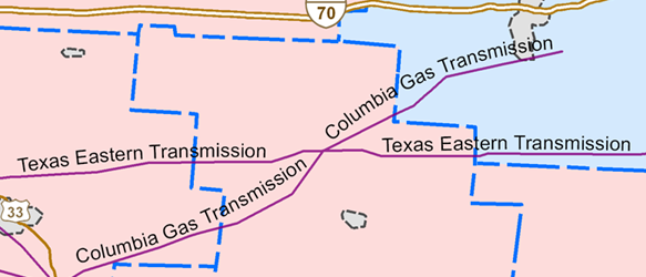

  • Minimize labels—The emphasis is on labeling the features so that a minimum number of labels are required. Rather than placing a label on either side of the junction for the same feature, it may place a single label on one side of the junction or the label may span the junction. The first image below illustrates this setting.

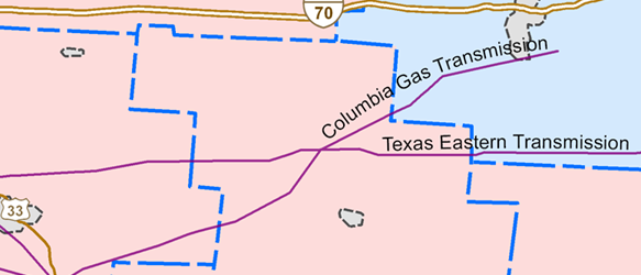

  • Unambiguous—Junctions in the network are labeled so there is no ambiguity about which feature is which. This tends to place more labels on the map than the Minimize labels option, because the same feature may be labeled on either side of the junction. This is the default. The second image below illustrates this setting.
Line connection set with Minimize labels option
Line connection set with Unambiguous type, which is the default
