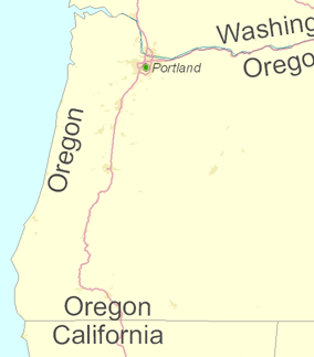

The following image shows the states of Washington, Oregon, and California labeled with the Boundary placement style. The Allow single sided boundary labeling option has been enabled.
Boundary labeling with Allow single sided boundary labeling enabled

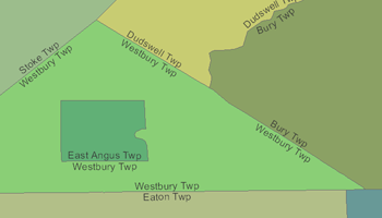

To label polygon holes, check the Allow boundary labeling of polygon holes check box. The following townships image illustrates this parameter. If the hole is empty, the Allow single sided boundary labeling check box must also be checked.
Boundary labeling with Allow boundary labeling of polygon holes enabled
