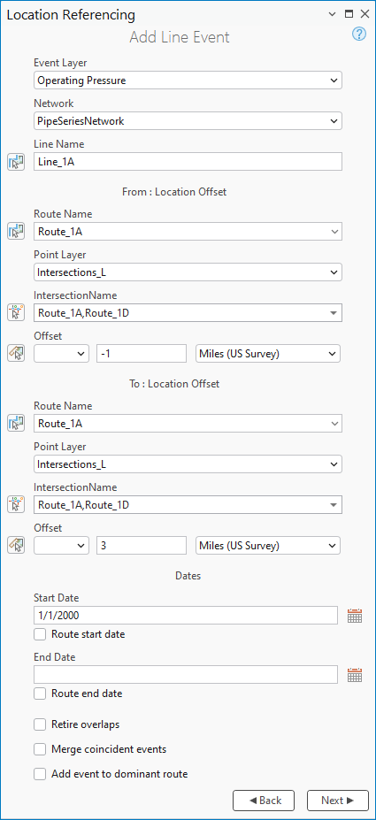

    The Event Layer drop-down menu, the Network drop-down menu, the Location Offset sections, and the Dates section appear in the Add Line Event pane.
  6. Click the Event Layer drop-down arrow and choose the line event layer.
    The parent LRS Network is populated based on the Event Layer value.
  7. If the network is a line network, specify the name of the line feature on which the events is located by doing one of the following:
    • Type a line name in the Line Name text box.
    • Click Choose line from map , and select the line on the map.
    The line is highlighted in light blue. The arrow at the end shows the direction of calibration of the line.
    Add Line Event pane with Location Offset sections
  8. In the From: Location Offset section, specify the route by doing one of the following:
    • Click the Route Name drop-down arrow and choose the route on which the event's from measure will be located.
    • Provide the route name in the Route Name text box.
    • Click Choose route from map and click the route on the map.
    Tip:
    If the parent LRS Network is a line network, you can also choose the route from the Route Name drop-down menu. Only routes that are part of the chosen line can be selected.
  9. Click the Point Layer drop-down arrow and choose the intersection, LRS point event, or non-LRS point layer name.
    Note:
    All the point layers that are published with the feature service are listed. LRS point events from a network other than the one specified under Network will not be listed. The LRS calibration point layer is not supported.
  10. For the text box below the Point Layer drop-down menu, specify the point feature's name by doing one of the following:
    • Provide the point feature's name in the text box.
    • Click the Choose location from map tool and click a point feature on the map.
    Note:
    • The name of the text box below the Point Layer drop-down menu is based on the point layer's display field. For intersections, the name of the text box will always be IntersectionName.
    • If more than one point feature exists at the clicked location, the Select Feature dialog box appears.
  11. Specify the Offset value for the location by doing one of the following:
    • Click the Offset drop-down arrow and choose the offset direction, provide the measure value, and choose the units.
    • Provide the measure value and choose the units.
    • Click Choose offset from map and click a location along the route on the map.
    A green dot appears at the offset location along the route on the map. This is the location of the start measure value for the event.
    Note:
    • The offset value is the distance between the chosen point layer and the proposed start measure on the selected route.
    • The direction is an optional selection.
    • If no direction is selected, a positive offset value places the start measure location along the direction of calibration from the selected point feature.
    • If no direction is selected, a negative offset value places the start measure location opposite the direction of calibration from the selected point feature.
  12. In the To: Location Offset section, specify the route by doing one of the following:
    • Click the Route Name drop-down arrow and choose the route on which the event's to measure will be located.
    If the routes are on a line in a line network, only routes that are part of the specified line can be selected.
  13. Click the Point Layer drop-down arrow and choose the intersection, LRS point event, or non-LRS point layer name.
    Note:
  14. For the text box below the Point Layer drop-down menu, specify the point feature's name by doing one of the following:
    Note:
  15. Specify the Offset value for the referent offset by doing one of the following:
    • Click the Offset drop-down arrow and choose the offset direction, provide a measure, and choose the units.
    • Click the Choose offset from map tool and click a location along the route on the map.
    A red dot appears at the offset location along the route on the map. This is the location of the end measure value for the events.
    Note:
    • The offset value is the distance between the chosen point layer and the proposed end measure on the selected route.
    • If no direction is selected, a positive offset value places the end measure location along the direction of calibration from the selected point feature.
    • If no direction is selected, a negative offset value places the end measure location opposite the direction of calibration from the selected point feature.
  16. Specify the date that defines the start date of the events by doing one of the following:
    • Provide the start date in the Start Date text box.
    • Click Calendar , and choose the start date.
    • Check the Route start date check box to use the route start date.
    Note:
    The start date cannot be before the start date of the selected route.
    The start date default value is today's date, but you can specify a different date.
  17. Specify the date that defines the end date of the events by doing one of the following:
    • Provide the end date in the End Date text box.
    • Click Calendar , and choose the end date.
    • Check the Route end date check box to use the route end date.
    If no end date is provided, the events remain valid from the event start date and into the future.
  18. Choose a data validation option to prevent erroneous input while characterizing a route with linear events as follows:
    • Retire overlaps—The measure, start date, and end date of existing events are adjusted to prevent overlaps with respect to time and measure values once the new line event or events are created.
      Learn more about retiring overlaps
      Retire overlaps behavior simple scenario
    • Merge coincident events—When all attribute values for a new event are exactly the same as an existing event, and if the new event is adjacent to or overlapping an existing event in terms of its measure values, and its time slices are coincident or overlapping, the new event is merged with the existing event and the measure range is expanded accordingly.
      Learn more about merging coincident events
      Merge coincident events simple scenario

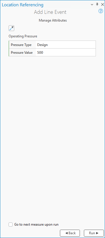

    Attributes for the chosen event layer appear in the Manage Attributes section.
    Note:
    Check the Go to next measure upon run check box to start your next edit at the end measure location of the previous edit. The To Method value and its populated information from the previous edit carry over to the next edit as the From Method value and its populated information.
    For example, if you use a From Method value of Location Offset and a To Method value of Coordinates to add a line event, enabling this option will start your next edit with From Method and To Method values of Coordinates with the coordinates information from the previous edit in the From: Coordinates section.
  20. Provide attribute information for the new event in the Manage Attributes section.
    Note:
    Click Copy attribute values by selecting event on the map , and click an existing line event belonging to the same event layer on the map to copy event attributes from that event.
    Add Line Event pane with the Manage Attributes section
  21. Click Run.
    The new line event is created and appears on the map. A confirmation message appears at the top of the pane once the newly added line event is created.

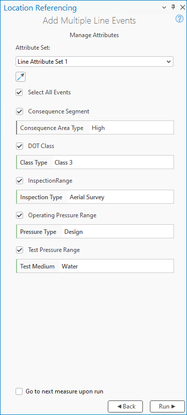

To create line events using location offset with the Add Multiple Line Events tool, complete the following steps:
  1. Open the map in ArcGIS Pro and zoom to the location where you want to add the line events.
  2. On the Location Referencing tab, in the Events group, click Add > Multiple Line Events .
    The Add Multiple Line Events pane appears with the default Route and Measure value for From Method and To Method.

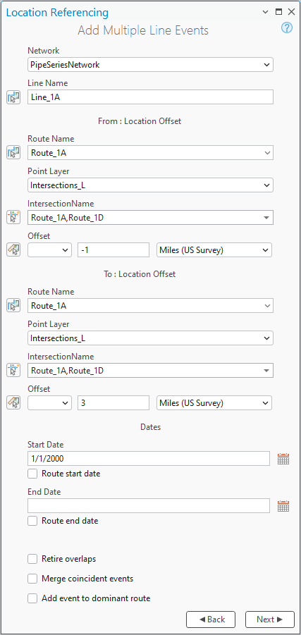

    The Network and Location Offset sections appear in the Add Multiple Line Events pane.
  6. Click the Network drop-down arrow and choose the parent LRS Network of the line event layer.
  7. If the network is a line network, specify the name of the line feature on which the events will be located by doing one of the following:
    • Provide a line name in the Line Name text box.
    • Click Choose line from map , and click a line on the map.
    Add Multiple Line Events pane with Location Offset sections
    • Provide the route name.
    If the routes are on a line in a line network, only routes that are part of the chosen line can be selected.
    Note:
    Note:
    Note:
    Note:
    Note:
    Note:
    Note:
  17. Optionally, specify the date that defines the end date of the events by doing one of the following:
    The end date is optional. If no end date is provided, the events remain valid from the event start date and into the future.
  19. Click Next.
    Manage Attributes appears with the default attribute set in the Attribute Set drop-down list.
    The Attribute Set list includes other attribute sets if configured.
    Note:
    Enable the Go to next measure upon run option to start your next edit at the end measure location of the previous edit. The end method and its populated information from the previous edit will carry over into the next edit as the start method and its populated information.
  20. Provide attribute information for the new events.
    Add Multiple Line Events pane with the Manage Attributes section
    Note:
    Click Copy attribute values by selecting event on the map , and click a route on the map to copy event attributes from another route.
  21. Click Run.
    The new line events are created and appear on the map. A confirmation message appears at the top of the pane once the newly added line events are created.
