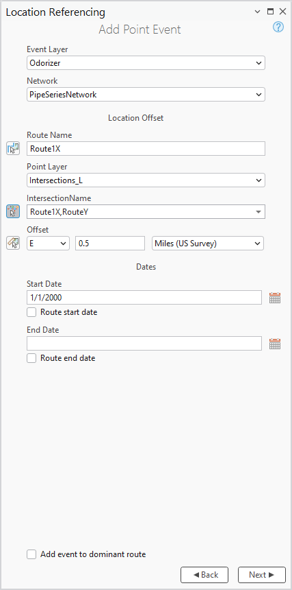

Add a point event by location offset
To add a point event by location offset, complete the following steps:
  1. Open the map in ArcGIS Pro and zoom to the location where you want to add the point event.
  2. On the Location Referencing tab, in the Events group, click Add > Point Event .
    The Add Point Event pane appears with the Route and Measure default value for Method.
  3. Click the Method drop-down arrow and choose Location Offset.
    Add Point Event pane with Location Offset method
  4. Click Next.
    The Event Layer drop-down menu, the Network drop-down menu, the Location Offset section, and the Dates section appear in the pane.
  5. Click the Event Layer drop-down arrow and choose the event layer where the event will be created.
    The Network value is populated based on the Event Layer value.
    Add Point Event with Location Offset section
  6. Specify the route name by doing one of the following:
    • Provide the route name in the Route Name text box.
    • Click Choose route from map and click a route on the map.
  7. Click the Point Layer drop-down arrow and choose the intersection, LRS point event, or non-LRS point layer name.
    Note:
    All the point layers that are published with the feature service are listed. LRS point events from a network other than the one specified under Network will not be listed. The LRS calibration point layer is not supported.
  8. For the text box below the Point Layer drop-down menu, specify the point feature's name by doing one of the following:
    • Provide the name of the point feature in the text box.
    • Click Choose location from the map and click a point feature on the map to populate the text box.
    Note:
    • The name of the text box below the Point Layer drop-down list is based on the point layer's display field. If a custom display field is set or the set display field does not have a value, the feature cannot be selected.
    • If more than one point feature exists at the clicked location, the Select Feature dialog box appears.
  9. Provide the Offset value for the location by doing one of the following:
    • Click the Offset drop-down arrow and choose the offset direction, provide a measure value, and choose the units.
    • Provide the measure value and choose the units.
    • Click Choose offset from map and click a location along the route on the map.
    A green dot appears at the offset location along the route on the map. This is the location of the measure value for the event.
    Note:
    • The offset value is the distance between the chosen point layer and the proposed measure on the selected route.
    • The direction is an optional selection.
    • If no direction is selected, a positive offset value places the measure location along the direction of calibration from the selected point feature.
    • If no direction is selected, a negative offset value places the measure location opposite the direction of calibration from the selected point feature.

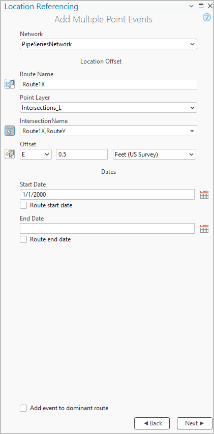

Add multiple point events by location offset
To add multiple point events by location offset, complete the following steps:
  1. Open the map in ArcGIS Pro and zoom to the location where you want to add the point events.
  2. On the Location Referencing tab, in the Events group, click Add > Multiple Point Events .
    The Add Multiple Point Events pane appears with a Route and Measure value for Method as the default.
    Add Multiple Point Events pane with Location Offset method
  4. Click Next.
    The Network drop-down menu, the Location Offset section, and the Dates section appear in the pane.
  5. Click the Network drop-down arrow and choose an LRS Network.
  7. Click the Point Layer drop-down arrow and choose the intersection, LRS point event, or non-LRS point event layer name.
    Note:
    All the point layers that are published with feature service are listed. LRS point events from a network other than the one specified under Network are not listed. The LRS calibration point layer is not supported.
    • Click Choose location from map and click a point feature on the map to populate the text box.
    Note:
    • The name of the text box below the Point Layer drop-down menu is dependent on the point layer's display field. If a custom display field is set or the display field set does not have a value, the feature cannot be selected.
  9. Specify the Offset direction for the location by doing one of the following:
    • Click the Offset drop-down arrow, choose the offset direction, provide the measure value, and choose the units.
    Note:

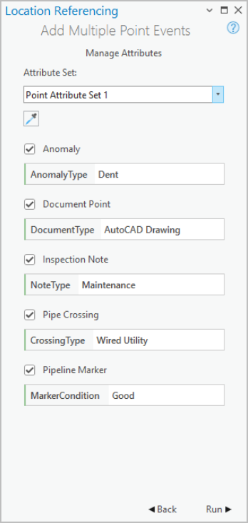

  12. Click Next.
    The Manage Attributes section appears.
    The Attribute Set drop-down menu includes other attribute sets if configured for the LRS Network.
  13. Optionally, choose an attribute from the Attribute Set drop-down menu.
    Note:
    You can uncheck the check box next to individual event layers to exclude them from event creation.
  14. Provide attribute information for the events in the attribute set.
    Add Multiple Point Events pane with Manage Attributes section
    Note:
    Click Copy attribute values by selecting event on the map and click an existing point event belonging to the same event layer on the map to copy event attributes from that event.
  15. Click Run.
    A confirmation message appears once the new point events are created and appear on the map.
