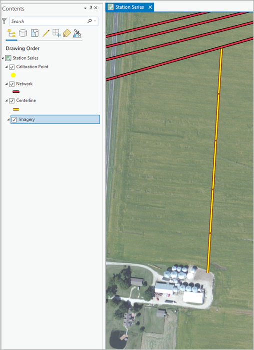

    The centerline features for the route must exist in the centerline feature class before creating the route.

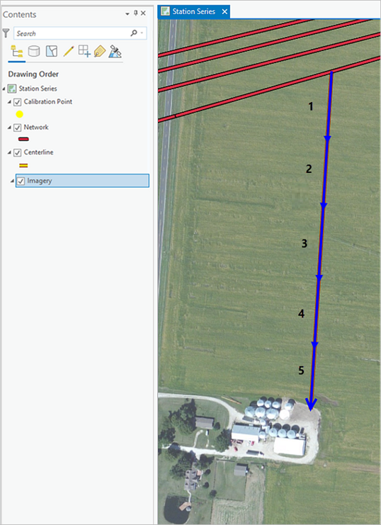

    A table appears in the Create Route pane with each chosen centerline in a numbered row that corresponds to the selection order. Chosen centerlines are numbered on the map and highlighted. The Chosen Centerlines count is shown above the table.
    Create Route pane with attributes table
  6. Optionally, choose one or more rows from the Order column, and use the buttons below the table to change the centerline selection order. You can also drag rows to change the order.
    Changes in the table selection order are also shown on the map.

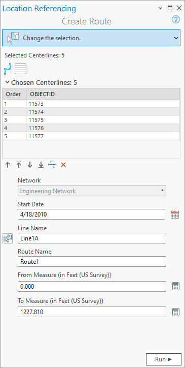

  7. Click the Network drop-down arrow and choose the network to which you want to add a route.
    Note:
    To edit using feature services, the LRS Network must be published with the Linear Referencing and Version Management capabilities.
  8. Click the Calendar button next to the Start Date text box and choose a start date for the route.
    Tip:
    You can also double-click the Start Date text box to insert the current date, or provide a date in the Start Date text box.
  9. If you're creating a route on a network that supports lines, provide a name in the Line Name text box.
    Create the route on a new or existing line:
    • To create the route on a new line, provide the line name in the Line Name text box. The line name must be unique for the chosen network.
    • To create the route on an existing line, provide the name of an existing line or use the Choose line from map button to select an existing line from the map.
  10. Provide a route name in the Route Name text box.
    The route name must be unique for the chosen network per the time slice.
  11. Provide a value in the From Measure text box. The default is 0.000.
    To calculate the start measure value, do the following:
    1. Provide a value in the To Measure text box.
    2. Click the Recalculate From Measure button next to the From Measure text box.
  12. Update the To Measure value if necessary.
    Note:
    The To Measure value is populated with the geometric length of the chosen centerline.

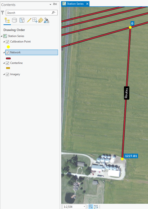

    Newly created route with start measure and end measure values
