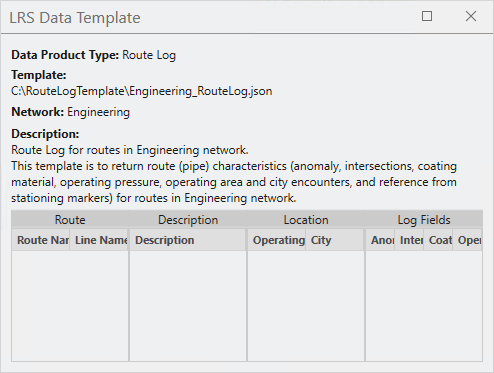

Set template properties

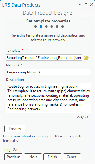

To set the template properties once the template type is specified, complete the following steps:
  1. Provide a template name.
    By default, the template is saved in the project folder. Optionally, browse to a different location, provide a name for the template, and click OK.
  2. Click the Network drop-down arrow and choose a network.
    Route characteristics are provided for this network when the Generate LRS Data Product tool is run with the template.
  3. Optionally, provide a description.
    Template properties are set on the Set template properties page

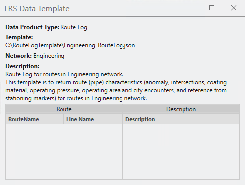

  4. Optionally, click Preview to preview the information on a canvas.
    The canvas after setting template properties
    Note:
    If the chosen network is a line network, the Line Name column appears in the route log next to the route identifier field.

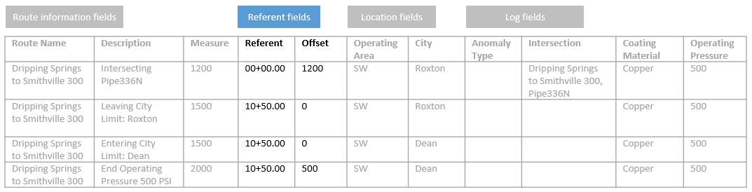

The next step to produce a template for a route log is to add a route identifier field and provide informative text. The route identifier can be a route name or route ID.
This example uses RouteName as the engineering network's route identifier field and Route Name as the display name in the Name in Table text box. The display name is also updated on the preview canvas. In the example route log, the start and end points of a route are Begin Pipe: Dripping Springs to Smithville 300 and End Pipe: Dripping Springs to Smithville 300, respectively.
To specify a route identifier field, complete the following steps:
  1. Click the Route Identifier drop-down arrow and choose a field.
    The default option is Route ID if the specified network is not a line network, or Route Name if the specified network is a line network.
    If the specified network has both a route ID and a route name configured, you can choose one of the two options using the drop-down arrow.
  2. Optionally, update the display name in the Name in Table text box.
    The default display name is the Route Identifier value.
  3. Optionally, update the text in the Feature Begin Text and Feature End Text text boxes to indicate the start and end of the routes.
    The default values are Begin and End, respectively.
  4. Optionally, provide text in the Field Value Prefix and Field Value Suffix text boxes to supplement information before and after the route identifier value, respectively.
    In the example, Pipe: is the prefix for the route identifier value. The example does not include a field value suffix.
    Choose a route identifier field and provide informative texts for a route log template

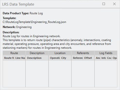

    The canvas after choosing a route identifier field
    Choosing a route identifier field ensures that the route log data product generated using this template includes route information fields.
    Route information fields in the route log after choosing a route identifier field
  5. Click Next.

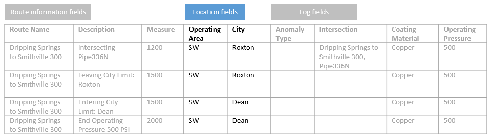

After adding log layers, you can add location layers and location fields. The location fields form the columns that contain information about the polygon boundaries crossed by the routes. You can also provide informative text for the location layers.
The example in this section uses Operating Area and City as the location layers. A route log data product generated using this template returns a record when a route enters or leaves an operating area or city.

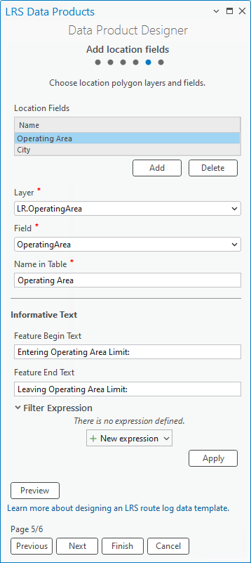

To add location fields, complete the following steps:
  1. Click Add to create a blank row in the Location Fields table.
  2. Click the Layer drop-down arrow and choose a location layer.
    The layer must be a polygon feature class stored in the same geodatabase or feature service and have the same coordinate system as the specified network when setting the template properties.
    The first location layer configured in the example is OperatingArea.
  3. Click the Field drop-down arrow and choose a field from the location layer specified.
    For this example, Operating Area is configured as the location field.
  4. Optionally, update the display name in the Name in Table text box.
    The default display name is the location field.
    This text updates the row in the Location Fields table.
  5. Optionally, provide text in the Feature Begin Text and Feature End Text text boxes.
    This text appears before the start and end of the location fields.
    For this example, the Feature Begin Text and Feature End Text text boxes are updated with Entering Operating Area Limit: and Leaving Operating Area Limit: text, respectively.

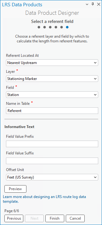

    The Select a referent field page appears.
After adding location layers, you can add a referent field from a referent layer. The referent field forms the columns that include referent and offset information. You can also provide informative text for the referent layer.
Note:
  • Configuring a referent field is optional. If you do not want to configure a referent field, click Finish to save the template.
  • You can configure only one referent layer for a route log template.
To configure a referent field, complete the following steps:
  1. Click the Referent Located At drop-down arrow and choose a referent method:
    • Nearest Upstream—The nearest referent feature upstream of the route log entry is used to calculate the referent offset. If no upstream referent feature exists, the referent values are empty.
    • Nearest—The nearest referent feature, upstream or downstream to the route log entry, is used to calculate the referent offset.
    The following image and table illustrate the difference between the two referent methods. The dent anomaly is 1,000 feet upstream from the nearest stationing marker, so the offset is -1000. Additionally, the dent anomaly is 6,000 feet from the nearest upstream stationing marker, so the offset is 6,000.
    A dent anomaly with two stationing markers on Route1
    Referent method
    Referent
    Offset (US Survey Feet)
    Nearest
    70+00.00
    -1000
    Nearest Upstream
    00+00.00
    6000
  2. Click the Layer drop-down arrow and choose a referent layer.
    The layer must be a point event or intersection stored in the same geodatabase or feature service and have the same coordinate system as the specified network when setting the template properties.
    For this example, Stationing Marker is configured as the referent layer.
  3. Click the Field drop-down arrow and choose a referent field.
    For this example, Station is the referent field.
    The default display name is Referent.
  5. Optionally, provide text in the Field Value Prefix and Field Value Suffix text boxes.
    The text provides information about the referent value and is inserted before and after the value, respectively.
  6. Optionally, click the Offset Unit drop-down arrow and choose a different unit.
    The default offset unit is Feet (International).
    For this example, the Offset Unit value is set to Feet (US Survey).
    Choose a referent layer and field for a route log template
    The canvas after adding a referent field
    By adding a referent field, the route log data products generated with this template have columns that include referent and offset information.
    Referent and offset information in the route log after choosing a referent field
  7. Click Finish to save the template.
The template is complete and can be used in the Generate LRS Data Product tool to generate an LRS data product.
