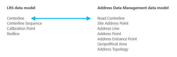

LRS and Address Data Management data models
The following are required feature classes for the Roads and Highways schema to integrate with the Address Data Management solution:
  • Centerline
  • Centerline Sequence
  • Calibration Point
  • Redline
The following are required Address Data Management solution feature classes to integrate with Roads and Highways:
  • Road Centerline
  • Site Address Point
  • Address Line
  • Address Point
  • Address Entrance Point
  • Geopolitical Area
  • Address Topology
