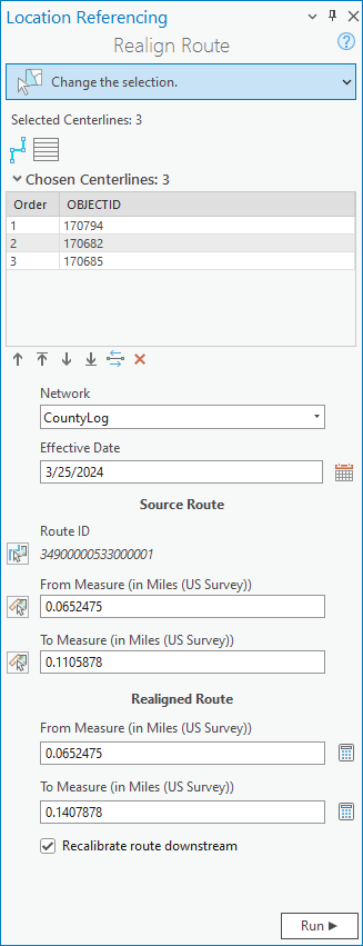

  5. Click Allow choosing of one or more centerlines .
    A table appears in the Realign Route pane with each chosen centerline in a numbered row that corresponds to the selection order. Chosen centerlines are numbered on the map and highlighted. The count is shown above the table.
    Realign Route pane

  7. In the Realign Route pane, choose the network in which you want to realign a route.
    Note:
    To edit using feature services, the LRS Network must be published with Linear Referencing and Version Management capabilities.
  8. Click the Effective Date drop-down arrow, and choose a date for the edit.
    Tip:
    You can also provide the date, or double-click the empty Effective Date text box to insert the current date.
  9. Optionally, if the centerline doesn't touch the route, use the pickers to populate the From Route Name, To Route Name, From Measure, and To Measure parameters.
    If the centerline touches the routes, the From Route Name, From Measure, To Route Name, and To Measure parameters in the Source Route section are automatically populated.

  10. Optionally, provide a start measure value.
    The From Measure value in the Realigned Route section is automatically populated. The suggested start measure value is the measure at the location where the start of the centerline touches the source route.
  11. Optionally, provide an end measure value.
    The To Measure value is automatically populated in the Realigned Route section.

  12. Click Run.
    The route is realigned.
