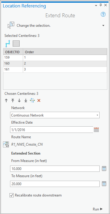

  5. Click Allow choosing of one or more centerlines .
    A table appears in the Extend Route pane with each chosen centerline in a numbered row that corresponds to the selection order. Chosen centerlines are numbered on the map and highlighted. The count is shown below the table.
    Extend Route pane with multiple centerlines chosen
    Note:
    The Recalibrate route downstream check box appears only when the route is extended at the beginning. If this option is checked, the measures downstream of the extension are updated.
  6. Optionally, choose one or more rows from the Order column, and use the buttons below the table to change the centerline selection order. You can also drag rows to change the order.
    Changes in the table selection order are also shown on the map.

  7. Choose the Network option that has a route you want to extend.
    Note:
    To edit using feature services, the LRS Network must be published with Linear Referencing and Version Management capabilities.
  8. Click Choose route from map to choose a route to extend.
    Note:
    After clicking Choose route from map , you can hover over the routes to see the route and measure at the location of the pointer.
    If only one applicable route exists at the edit location on the map, click the route name to select it. If multiple routes are applicable, click the location and choose one of the applicable routes from the Select Route dialog box.
    You can set map scale options for the display of route and measure information on the Options dialog box, on the Location Referencing tab.
    Tip:
    You can't extend a route to fill a gap between routes.
  9. Click the Calendar and specify the start date.
    • Alternatively, provide the date in the Effective Date text box.
    • Double-click the empty Effective Date text box to populate today's date.
  10. Verify that the automatically populated From Measure value appears as expected in the Extended Section.
    • If the route is being extended at the end, the suggested From Measure value is the same as the To Measure value of the original route.
    • If the route is being extended from the beginning, the suggested From Measure value is 0.
  11. Alternatively, provide a From Measure value.
    If you do not know the start measure, allow ArcGIS Roads and Highways to suggest it. Click Recalculate From Measure to do so. This value is calculated as the difference between the To Measure value and the geometric length of the centerline.
  12. Verify that the automatically populated To Measure value appears as expected in the Extended Section.
    Note:
    • If the route is being extended at the end, the suggested To Measure value is the suggested From Measure value plus the geometric length of the centerline.
    • If the route is being extended from the beginning, the suggested To Measure value is the suggested From Measure value plus the geometric length of the centerline.
  13. Alternatively, provide a To Measure value of your choice.
    If you do not know the end measure, allow Roads and Highways to suggest it. Click Recalculate To Measure to do so. This value is calculated as the sum of the From Measure value and the geometric length of the centerline.
  14. Click Run.
