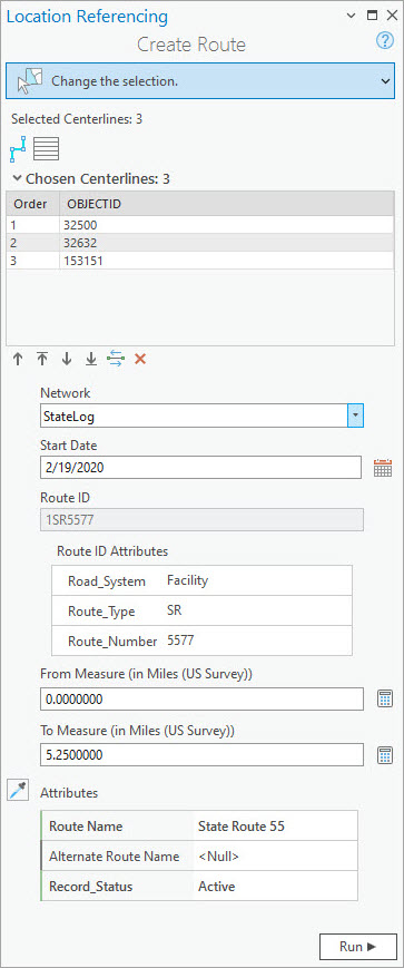

  5. Click the Allow choosing of one or more centerlines button .
    A table appears in the Create Route pane with each chosen centerline in a numbered row that corresponds to the selection order. Chosen centerlines are numbered on the map and highlighted. The Chosen Centerlines count is shown above the table.
    Create Route pane with Route ID Attributes
  6. Optionally, choose one or more rows from the Order column, and use the buttons below the table to change the centerline selection order. You can also drag rows to change the order.
    Changes in the table selection order are also shown on the map.

  7. Click the Network drop-down arrow and choose the network to which you want to add a route.
    Note:
    To edit using feature services, the LRS Network must be published with Linear Referencing and Version Management capabilities.
    Depending on the network configuration you are using, you may have a multifield route ID to provide. If that's the case, the Create Route pane appears with Route ID Attributes to configure attributes.
  8. Click the Calendar button next to Start Date and choose a start date for the route.
    Tip:
    You can also double-click the Start Date text box to insert the current date, or provide a date in the Start Date text box.
  9. Provide a value in the Route ID text box.
    The route ID must be unique for the chosen network per the time slice. If you're using a multifield route ID, create the route ID by selecting or providing values for the fields that comprise the route ID. This is configured using the Modify LRS Network tool.
    The image in step 5 shows Route ID Attributes with values that are used to create the route ID.
  10. Provide a value in the From Measure text box. The default is 0.000.

Example 3: Output Measures
Route ID
From Measure
To Measure
Line Order
R1
15
100
R3
14
20
200
R2
17
20
300
Example 3 Output Measures: A new route, R3, is created by selecting CL2 and the line order of R2 is updated.
