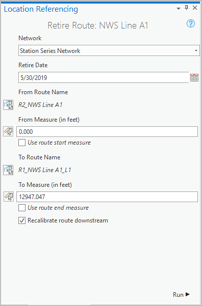

Retire routes
To retire routes, complete the following steps:
Note:
Gap calibration rules are followed when editing routes.
  1. Add the centerline and network feature class to a map.
    Alternatively, open a map in which the centerline and network feature class are present.
    Note:
    • In the data model, only one centerline is expected at any given location. Ensure that the centerlines used for your edit do not overlap other centerlines in the LRS.
    • Branch versioned networks, including any network configured with a user-generated route ID, must be edited through a feature service.
  2. Zoom in to the location where you want to retire the route.
  3. On the Location Referencing tab, in the Routes group, click Retire .
    The Retire Route pane appears.
    Retire Route pane
  4. Click the Network drop-down arrow and choose the network that contains the route to retire.
    Note:
    To edit using feature services, the LRS Network must be published with the Linear Referencing and Version Management capabilities.
  5. Click the Retire Date drop-down arrow and choose a retire date.
    • Alternatively, provide the date in the Retire Date text box.
    • Double-click the empty Retire Date text box to populate the current date.
  6. Click the Choose route from map button to choose a route to retire for the From Route Name parameter.
    Note:
    After clicking the Choose route from map button or the Choose measure from map button , you can hover over the routes to see the route and measure at the location of the pointer.
    If only one applicable route exists at the edit location, click to select it. If multiple routes are applicable, click to select one of the applicable routes using the Select Route dialog box.
    You can set map scale options for display of route and measure information on the Options dialog box, on the Location Referencing tab.
  7. Provide the start measure in the From Measure text box or click the Choose measure from map button to set the value.
    Tip:
    You can also check the Use route start measure check box to choose the start measure of the route.
    A green dot is placed on the start measure location of the route.
  8. Click the Choose route from map button to choose a route to retire for the To Route Name parameter.
    If the retirement is limited to one route, the From Route Name and To Route Name values are the same.
  9. Provide the end measure in the To Measure text box or click the Choose measure from map button to set the end measure.
    Tip:
    You can also check the Use route end measure check box to choose the end measure of the route.
    Note:
    For the line network, the measures can be entered as station values in 00+00.00 or 00+00.000 format.
    Optionally, check the Recalibrate route downstream check box to remove the length of the retired route from the overall set of measures.
    If the Recalibrate route downstream check box is unchecked, a measure gap may be created on the route if the retirement is not at the endpoint of the route.
    You can't retire the routes if the From Measure value equals the To Measure value for the same route.
    A red dot is placed on the end measure location of the route.
  10. Click Run.
