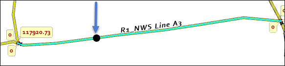

  4. Click any location on the route.
    Note:
    • Place the pointer over the location to edit to display route and measure information on the map. The route and measure update as you move the pointer. If multiple routes and measures exist at a location, they are shown.
    • If only one applicable route exists at the edit location, click to split the centerline at that point. If multiple routes are applicable, click to select one of the applicable routes using the Select Route dialog box.

    Centerline to be split by measure
