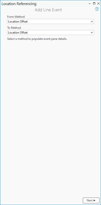

  2. On the Location Referencing tab, in the Events group, click Add > Line Event .
    The Add Line Event pane appears. The From Method and To Method drop-down lists are populated with the Route and Measure value by default.
  3. Click the From Method drop-down arrow and choose Location Offset.
  4. Click the To Method drop-down arrow and choose Location Offset.
    Using the Location Offset method, the measure location is based on an offset from a specified location.
    Add Line Event pane
  5. Click Next.

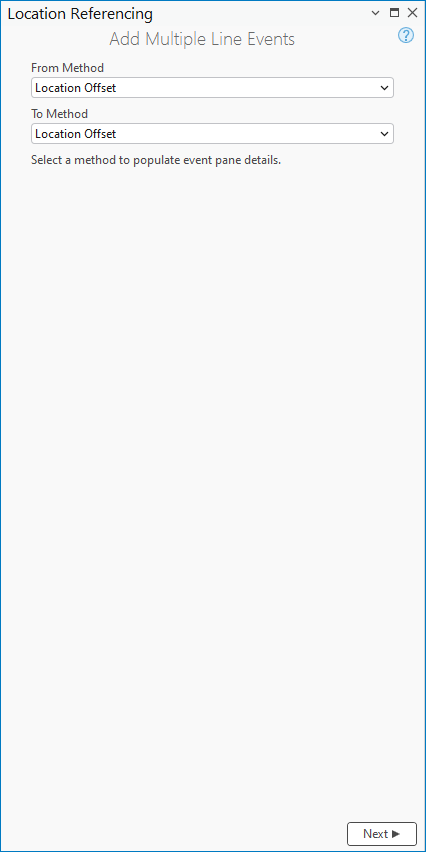

  2. On the Location Referencing tab, in the Events group, click Add > Multiple Line Events .
    The Add Multiple Line Events pane appears with the default Route and Measure value for From Method and To Method.
  5. Click Next.

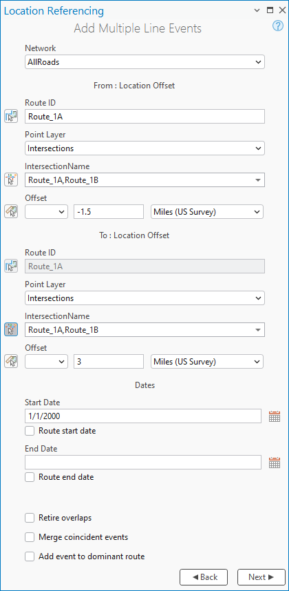

  6. Click the Network drop-down arrow and choose the parent LRS Network of the line event layer.
  7. In the From: Location Offset section, specify the route by doing one of the following:
    • Provide the route ID in the Route ID text box.
    • Click Choose route from map and click the route on the map.
  8. Click the Point Layer drop-down arrow and choose the intersection, LRS point event, or non-LRS point layer name.
    Note:
    All the point layers that are published with the feature service are listed. LRS point events from a network other than the one specified under Network will not be listed. The LRS calibration point layer is not supported.
  9. For the text box below the Point Layer drop-down menu, specify the point feature's name by doing one of the following:
    • Provide the point feature's name in the text box.
    • Click the Choose location from map tool and click a point feature on the map.
    Note:
    • The name of the text box below the Point Layer drop-down menu is based on the point layer's display field. For intersections, the name of the text box will always be IntersectionName.
    • If more than one point feature exists at the clicked location, the Select Feature dialog box appears.
  10. Specify the Offset value for the location by doing one of the following:
    • Click the Offset drop-down arrow and choose the offset direction, provide the measure value, and choose the units.
    • Provide the measure value and choose the units.
    • Click Choose offset from map and click a location along the route on the map.
    A green dot appears at the offset location along the route on the map. This is the location of the start measure value for the event.
    Note:
    • The offset value is the distance between the chosen point layer and the proposed start measure on the selected route.
    • The direction is an optional selection.
    • If no direction is selected, a positive offset value places the start measure location along the direction of calibration from the selected point feature.
    • If no direction is selected, a negative offset value places the start measure location opposite the direction of calibration from the selected point feature.
