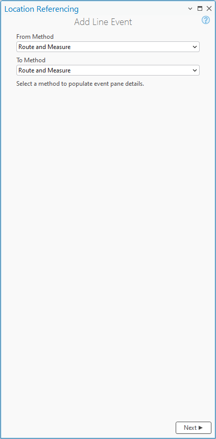

  2. Click the Location Referencing tab, and in the Events group, click Add > Line Event .
    The Add Line Event pane appears with the Route and Measure default value as the From Method and To Method values.
    Using the Route and Measure method, the measure location is based on the measure values from the selected route.

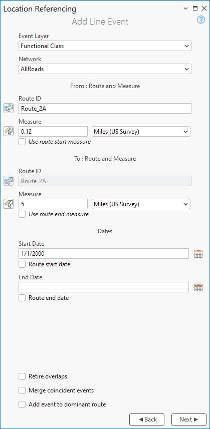

  3. Click Next.
    The route, measure, and date text boxes appear in the Add Line Event pane.
    Add Line Event pane with route and measure and dates sections
  4. Click the Event Layer drop-down arrow, and choose a line event layer.
    The Network layer is automatically populated once the event layer is chosen. The network serves as the source linear referencing method (LRM) to define the input measures for the event.
    The network is an LRS Network published as a layer in the feature service.
  5. Click Choose route from map and click the route on the map to populate the Route ID value.

  6. In the From: Route and Measure section, specify the start measure by doing one of the following to populate the Measure text box:
    • Click Choose measure from map , and click the start measure value along the route on the map.
    • Check the Use route start measure check box.
    • Provide the start measure value in the Measure text box.

  7. Optionally, in the To: Route and Measure section, specify the end measure for the new line event along the route by doing one of the following to populate the Measure text box:

    A red point appears at the selected location on the map. The event will be created between the green and the red points.
  8. Specify the start date of the event by doing one of the following:
    • Click Calendar , and choose the start date.
    • Provide the start date in the Start Date text box.
    • Check the Route start date check box.
    • Double-click in the Start Date text box to use the current date.
    The start date default value is the current date, but you can choose a different date using the date picker.
  9. Optionally, specify the end date of the event by doing one of the following:
    • Click Calendar and choose the end date.
    • Provide the end date in the End Date text box.
    • Check the Route end date check box.
    • Double-click in the End Date text box to use the current date.
    If no end date is provided, the event remains valid from the route start date into the future.
  10. Choose a data validation option to prevent erroneous input while characterizing a route with line events.
    • Retire overlaps—The measure, start date, and end date of existing events are adjusted to prevent overlaps with respect to time and measure values once the new line event or events are created. For more information, refer to the retire overlaps scenarios.

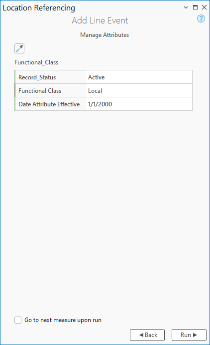

  11. Click Next.
    The attributes for the chosen event layer appear under the Manage Attributes section.

  12. Provide attribute value information for the event.
    The Manage Attributes section in the Add Line Event pane

  13. Click Run.
    A confirmation message appears once the line event is added and appears on the map.
