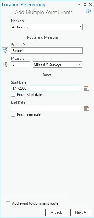

    The Route and Measure and Dates sections appear in the Add Multiple Point Events pane.
  4. Click the Network drop-down arrow and choose the network that is the source for the event layers.
  5. Specify the route where the point events will be created by doing one of the following:
    • Provide a route name in the Route ID text box.
    • Click Choose route from map and click the point on the route where you want to add the point events.
    Tip:
    After clicking Choose route from map or Choose measure from map , hover over the routes to see the route and measure at the location of the pointer.
    You can set map scale options for display of route and measure information on the Options dialog box, on the Location Referencing tab.
    Note:
    If a message regarding acquiring locks or reconciling appears, conflict prevention is enabled.
    After a route is selected, the tool will attempt to release the route lock if the route lock is acquired by the active user in a different version and its releasable status value is Yes.
  6. Specify a new location by doing one of the following:
    • Provide the value in the Measure text box.
    • Click Choose route from map and click the measure value along the route on the map.
    Once the measure is provided, a green dot appears on the map at that measure location.
