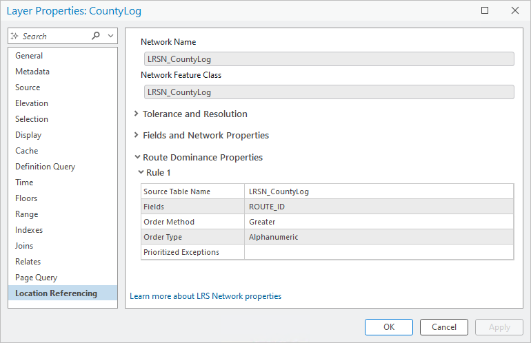

The route dominance rule is set as Greater Alphanumeric on Route ID. Using this condition, Route 200 is the most dominant route, and Route 100 is the most subordinate route.
Route Dominance Properties section on the Location Referencing tab of the Layer Properties dialog box

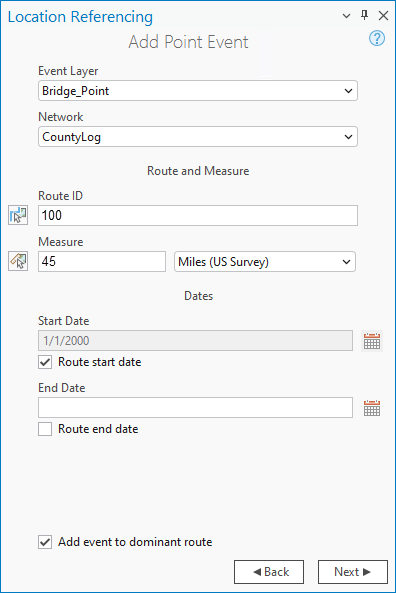

    The Route and Measure fields appear in the Add Point Event pane.
  4. Click the Event Layer drop-down arrow and choose the point event layer where you want to add the event.
    The selected Network value is based on the selected event layer.
  5. Specify a route by doing one of the following:
    • Provide a route ID in the Route ID text box.
    • Click Choose route from map and click on the route where you want to add the point event.
    The measure is initially populated using the route location you clicked.
    Tip:
    After clicking Choose route from map or Choose measure from map , hover over the route to see the route and measure at the location of the pointer.
    You can choose a scale for the display of route and measures.
    Note:
    If a message regarding acquiring locks or reconciling appears, conflict prevention is enabled.
  6. Specify a new location by doing one of the following:
    • Provide the value in the Measure text box.
    • Click Choose measure from map and click the measure value along the route on the map.
    Once the measure is provided, a green dot appears on the map at that measure location.
    Note:
    If you chose another method, a green dot appears on the map at the measure location that the input of the chosen method is translated to.
  7. The start date default value is the current date, but you can change the date by doing one of the following:
    • Provide the start date in the Start Date text box.
    • Click Calendar and choose the start date.
    • Check the Route start date check box.
  8. Optionally, specify the end date for the point event by doing one of the following:
    • Provide the end date in the End Date text box.
    • Click Calendar and choose the end date.
    • Check the Route end date check box.
    If no end date is provided, the event remains valid from the event start date into the future.
  9. Check the Add event to dominant route check box.

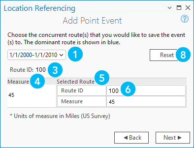

    The time drop-down menu shows the time slice for the particular concurrency shown below. If there is only one time slice for the concurrency scenario, the drop-down menu is disabled.
    To configure adding events in another time slice, choose another time slice from the drop-down menu.
    As an example, route 100 has a From Date value of 1/1/2000, and route 200 has a From Date value of 1/1/2010. If you choose 1/1/2000 as the start date of the event, there will be two time ranges:
    1/1/2000-1/1/2010, when only route 100 exists.
    1/1/2010-Null, when both routes existed.
    The Route ID label shows the selected route from the previous pane.
    The Measure column shows the measure value in the network's default measure unit on the selected route from the previous pane.
    5
    The Selected Route columns show the Route ID and Measure values for each dominant route where the events will be added.
    6
    A route ID in black text without a drop-down arrow signifies that there was a single route in that location.

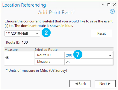

    7
    A route ID in blue text with a drop-down arrow signifies that there are concurrent routes in that location, and the blue route is selected automatically based on the route dominance rules. You can choose any other route using the drop-down arrow, and the chosen subordinate route is shown in black.
    Note:
    If you chose another method, the Measure values indicate the measure of the location from the input of the chosen method.
    8
    The Reset button resets the selected route to the dominant route based on the route dominance rules across all time slices.
    For the 1/1/2000 – 1/1/2010 time slice, the event can only be added on route 100. For the 1/1/2010 – Null time slice, you would choose route 200. The Measure value along the selected route is the measure for that route at the same location in the specific time range.

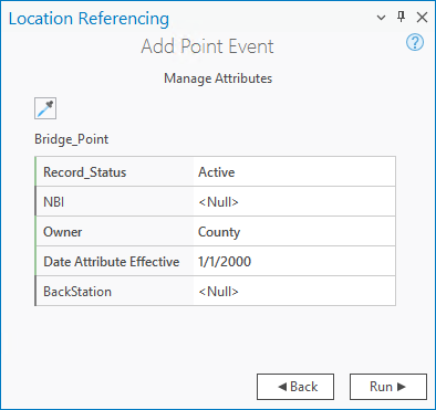

    The attributes for the chosen point event layer appear under Manage Attributes.
    Manage Attributes table
    Note:
    Coded value domains, range domains, subtypes, contingent values, and attribute rules are supported when configured for a field.
  12. Provide attribute information for the new event in the table.
