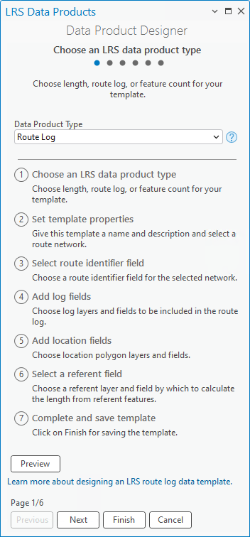

Choose an LRS data product type
The first step in the Data Product Designer wizard is to specify the data product type.
To specify the Route Log data product type, complete the following steps:
  1. Start ArcGIS Pro and open a project with LRS data in the map.
  2. On the Location Referencing tab, in the LRS Data Products group, click Data Product Designer .
    The Choose an LRS data product type page of the Data Product Designer wizard appears.
  3. Click the Data Product Type drop-down arrow and choose Route Log.
    Route Log data product type on the Choose an LRS data product type page
  4. Click Next.
    The Set template properties page appears.

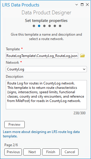

To set the template properties once the template type is specified, complete the following steps:
  1. Provide a template name.
    By default, the template is saved in the project folder. Optionally, browse to a different location, provide a name for the template, and click OK.
  2. Click the Network drop-down arrow and choose a network.
    Route characteristics are provided for this network when the Generate LRS Data Product tool is run with the template.
  3. Optionally, provide a description.
    Template properties are set in the Set template properties page

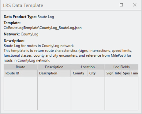

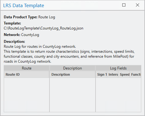

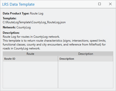

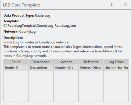

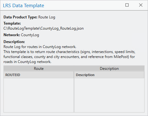

  4. Optionally, click Preview to preview the information in a canvas.
    The canvas after setting template properties
    Note:
    If the chosen network is a line network, the Line Name column appears in the route log next to the route identifier field.

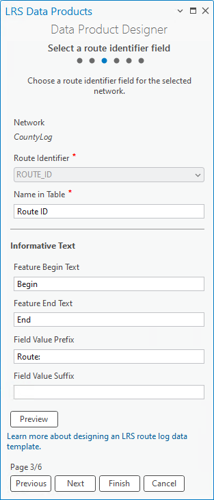

Select a route identifier field
The next step to produce a template for a route log is to add a route identifier field and provide informative text. The route identifier can be a route name or route ID.
This example uses ROUTE_ID as the network's route identifier field and Route ID as the display name in the Name in Table text box. The display name is also updated in the preview canvas. In the example route log, the start and end points of a route are Begin Route: SR9WB and End Route: SR9WB.
To specify a route identifier field, complete the following steps:
  1. Click the Route Identifier drop-down arrow and choose a field.
    The default option is Route ID if the specified network is not a line network, or Route Name if the specified network is a line network.
    If the specified network has both a route ID and a route name configured, you can choose one of the two options using the drop-down arrow.
  2. Optionally, update the display name in the Name in Table text box.
    The default display name is the Route Identifier value.
  3. Optionally, update the text in the Feature Begin Text and Feature End Text text boxes to indicate the start and end of the routes.
    The default values are Begin and End, respectively.
  4. Optionally, provide text in the Field Value Prefix and Field Value Suffix text boxes to supplement information before and after the route identifier value, respectively.
    In the example, Route: is the prefix for the route identifier value. The example does not include a field value suffix.
    Choose a route identifier field and provide informative texts for a route log template
    The canvas after choosing a route identifier field

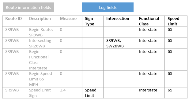

    Choosing a route identifier field ensures that the route log data product generated using this template includes route information fields.
    Route information fields in the route log after choosing a route identifier field
  5. Click Next.

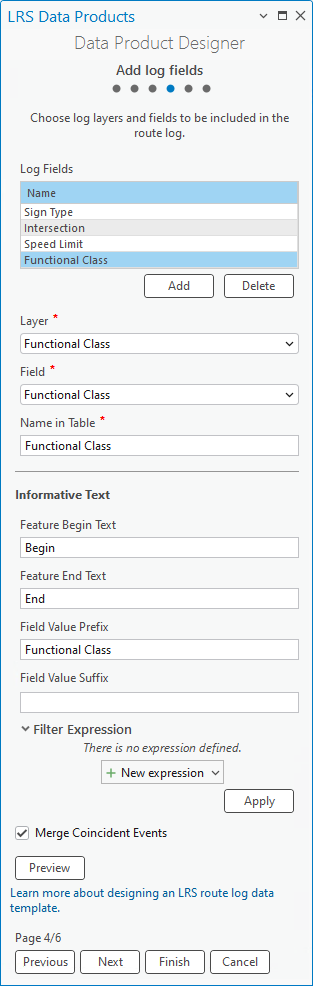

Add log fields

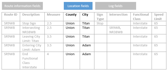

In a route log data product, the log fields form the columns that include event and intersection information. You can add log fields from log layers and supplement informative text. Informative text provides details about the log layers.
Note:
A centerline feature class can also be used as a log layer when it is configured with the Address Data Management solution or a utility network.
The example in this section uses four log layers:
  • Signs point event
  • Intersection
  • Speed Limit line event
  • Functional Class line event
An LRS route log data product generated using this template returns a record when any of these layers appear and end on a route.
Note:
Adding log fields is optional. If you don't want to add log fields to the template, click Next to proceed to adding location fields.
To add log fields, complete the following steps:
  1. Click Add to create a blank row in the Log Fields table.
  2. Click the Layer drop-down arrow and choose a log layer.
    The layer can be a point event, a line event, or an intersection that is registered to the network specified when setting the template properties. It must be stored in the same geodatabase or feature service and have the same coordinate system as the specified network. The layer you specify determines which fields are available for the Field menu.
    The first log layer configured in the example is the Signs point event.
  3. Click the Field drop-down arrow and choose a field from the layer specified.
    For this example, Sign Type is configured as one of the log fields.
  4. Optionally, update the display name in the Name in Table text box.
    The default display name is the Field value.
    This text updates the row in the Log Fields table.
  5. Optionally, provide text in the Feature Begin Text and Feature End Text text boxes.
    This text appears before the start and end of log fields.
    Note:
    The Feature Begin Text and Feature End Text text boxes are not available when using a point event layer or an intersection layer.
  6. Optionally, provide Field Value Prefix and Field Value Suffix text.
    This text provides additional information about the log value and is inserted before and after the log value, respectively.
    In the example below, Speed Limit is the Field Value Prefix value and MPH is the Field Value Suffix value added for the Functional Class line event.
    Speed Limit entries with informative texts
  7. Optionally, click New expression to define an expression that filters specific log values.
    Only features that meet the filter expression are returned in route log. For example, FUNCTIONAL_CLASS = 1 returns only interstate functional classes.
  8. Optionally, check the Merge Coincident Events check box for line event log layers.
    Checking this box returns coincident events with the same value in the log field as a single event in the route log.
  9. If you want to add multiple log fields, repeat the previous steps for each field.
    For this example, Sign Type, Intersection, Speed Limit, and Functional Class are configured as log fields.
    Choose log layers and fields to be included in the route log
    The canvas after adding log fields
    By adding log fields, route log data products generated with this template have columns that include event and intersection information.
    Log fields in the route log after adding log fields

Add location fields
After adding log layers, you can add location layers and location fields. The location fields form the columns that contain information about the polygon boundaries crossed by the routes. You can also provide informative text for the location layers.
The example in this section uses County and City as the location layers. A route log data product generated using this template returns a record when a route enters or leaves a county or city.
Note:
Adding location fields is optional. If you don't want to add location fields to the template, click Next to proceed to selecting a referent field.

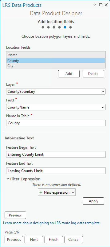

To add location fields, complete the following steps:
  1. Click Add to create a blank row in the Location Fields table.
  2. Click the Layer drop-down arrow and choose a location layer.
    The layer must be a polygon feature class stored in the same geodatabase or feature service and have the same coordinate system as the specified network when setting the template properties.
    The first location layer configured in the example is CountyBoundary.
  3. Click the Field drop-down arrow and choose a field from the location layer specified.
    For this example, County is configured as the location field.
    The default display name is the location field.
    This text updates the row in the Location Fields table.
  5. Optionally, provide text for the Feature Begin Text and Feature End Text text boxes.
    This text appears before the start and end of the location fields.
    For this example, the Feature Begin Text and Feature End Text text boxes are updated to Entering County Limit: and Leaving County Limit:, respectively.
  6. Optionally, click the Filter Expression drop-down arrow and provide an expression to filter by a specific location field.
    Only features that meet the filter expression are returned in the route log.
    The example does not have a filter expression configured for location fields. One example of a filter expression, REGION = "SOUTHWEST", returns only route interactions with counties in the southwest region.
  7. If you want to add multiple location fields, repeat the previous steps for each field.
    The example has two location fields, County and City.
    Add location fields to be included in the route log
    The canvas after adding location fields

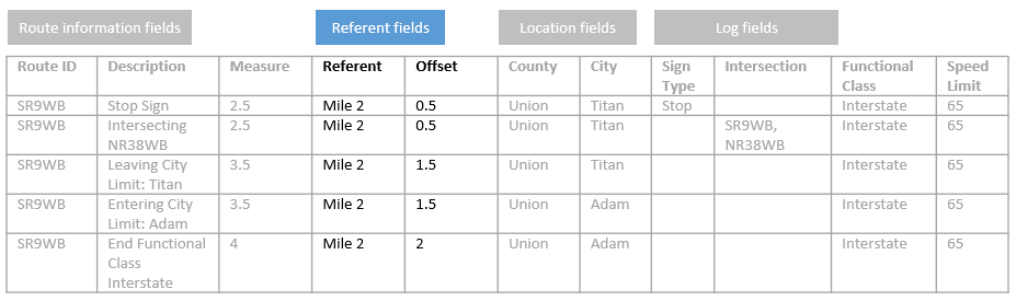

    By adding location fields, the route log data products generated with this template have columns that contain records of when a route enters or leaves a location.
    The location fields in the route log after adding location fields

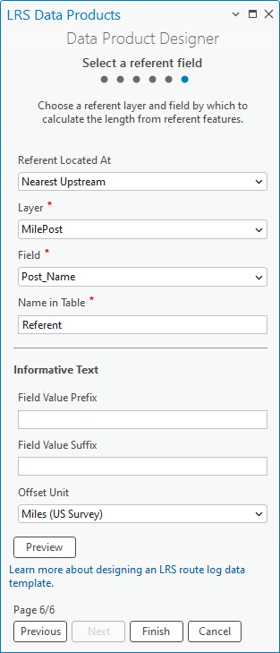

    The Select a referent field page appears.
After adding location layers, you can add a referent field from a referent layer. The referent field forms the columns that include referent and offset information. You can also provide informative text for the referent layer.

    The following graphic and table illustrate the difference between the two referent methods. The stop sign event is 1 mile upstream from the nearest mile post, so the offset is -1. Additionally, the stop sign is 6 miles from the nearest upstream mile post, so the offset is 6.
    A stop sign with two mile posts on Route1
    Referent method
    Referent
    Offset (US Survey Miles)
    Nearest
    Mile 7
    -1
    Nearest Upstream
    Mile 0

    Choose a referent layer and field for a route log template
    The canvas after adding a referent field
    By adding a referent field, the route log data products generated with this template have columns that include referent and offset information.
    Referent and offset information in the route log after choosing a referent field
