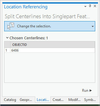

  4. Click the Select one or more centerlines drop-down arrow and choose a selection method.
  5. On the map, select one or more centerlines that you want to split.
    The selected centerlines are highlighted on the map and the Chosen Centerlines section appears in the pane with the centerlines listed in order of selection.
    Split Centerlines Into Singlepart Features pane with chosen centerlines

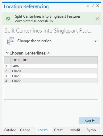

  6. Click Run.
    The selected multipart centerlines are split and the newly separated centerlines flash in cyan on the map.
    The Chosen Centerlines section lists each of the newly created singlepart centerline features.
    Split Centerlines Into Singlepart Features pane after the singlepart features are created
    Clicking a singlepart centerline feature in the Chosen Centerlines section causes it to flash on the map.
