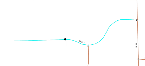

    The route is highlighted in cyan and a point appears at the clicked location.
    Centerline to be split by measure

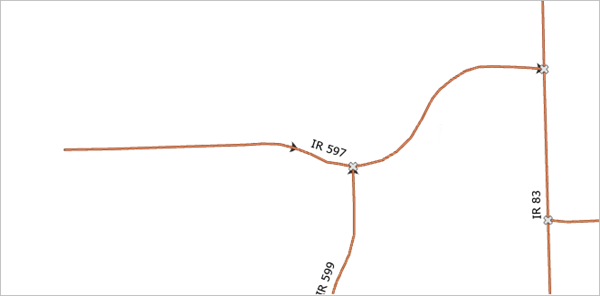

    The centerline is split and flashes on both sides of the route's measure value.
    Split Centerline by Measure result
