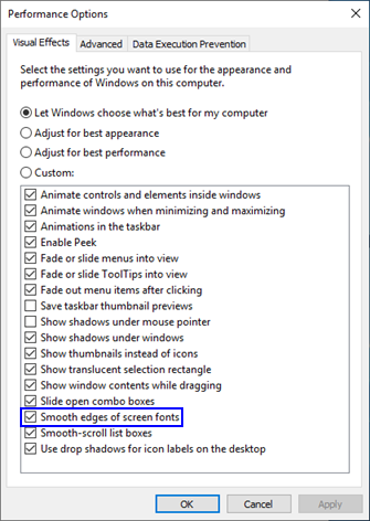

In ArcMap, text and character marker antialiasing is controlled by the font smoothing settings configured in the machine's display settings. These settings are set per user and are not configured as part of the application.
Windows Performance Options dialog box font smoothing properties
Font smoothing settings vary between operating systems.
In ArcGIS Pro, these settings are configured within the application's options.

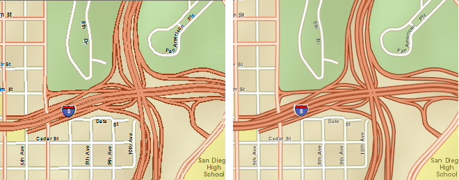

Line aliasing examples
An example of aliasing due to more precise rendering is shown. The first image shows ArcGIS Pro. The second image shows ArcMap.
ArcGIS Pro is capable of applying antialiasing to alleviate the effects of the changed appearance, but there are some cases in which antialiasing is not the best option. For example, using antialiasing can reduce drawing performance. Depending on the requirements of the map, this may be unacceptable. Also, for target export formats that use an 8-bit palette (such as PNG 8 or GIF formats), antialiasing may not be as effective due to the dithering required to render continuous progressions of color.

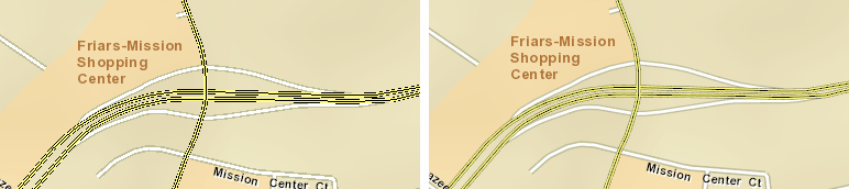

Antialiasing examples
Antialiasing can greatly improve a line's appearance, but at the cost of performance. The first image shows no antialiasing. The second image shows best antialiasing.
Line aliasing before and after fix
The first image shows original line widths of the expressway symbol rendered in ArcGIS Pro. The second image shows the line widths after correction. Note that the casing lines no longer appear dashed in the corrected version.
To alleviate this situation, manually change the size of the multilayer line symbol so that the line sizes are more appropriate. This also allows conversion for use with a target dpi other than 96 dpi (for instance, a target resolution of 120 dpi).

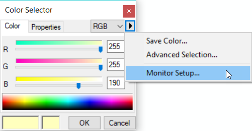

To minimize the color differences in a map service, change the monitor settings within ArcMap. This can be useful when authoring a map to import into ArcGIS Pro.
To access the monitor settings, on any Symbol Properties dialog box, click the drop-down menu on the color swatch and choose More Colors.
Simple color picker
On the Color Selector dialog box, click the arrow button and choose Monitor Setup.

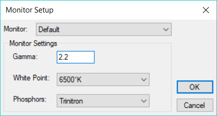

On the Monitor Setup dialog box, change the Gamma setting to 2.2 and click OK to close the dialog box.
This instructs ArcMap to use a gamma value that more closely matches the color profile used by the drawing engine of ArcGIS Pro.
Note:
This setting only affects the appearance of maps drawn by the user and the computer on which this modification is performed.
