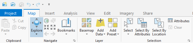

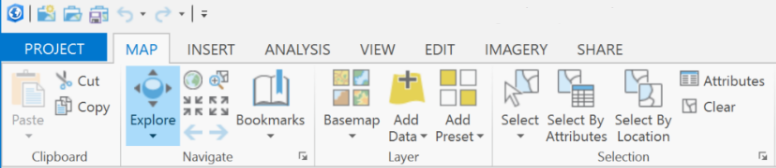

Tab Captions
Tab captions on the Pro Ribbon are now Title Case and not ALL CAPS. At 2.0 or later, consider title casing any custom TAB captions in your respective add-in config.daml files.
1.x, ALL CAPS:
2.0, Title Case:

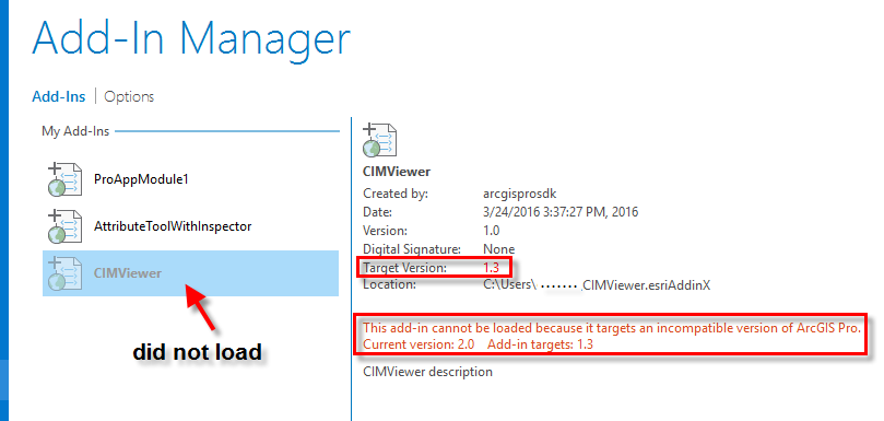

Add-in and Configuration Does Not Load
In many cases you may already have add-ins or configurations installed on your machine when you upgrade Pro and you do not (or did not) run RegisterAddin.exe. When you run Pro you notice that your custom tab or buttons are missing from the Pro UI. The probable cause is that the add-ins or configuration have not been migrated from 1.x and were skipped in the loading sequence. To confirm this (especially if you are not the owner of the source code) you can:
Either:
  • Run ArcGISPro.exe with the /enablediagnostics command line argument to enable event logging (you may need to use a desktop shortcut to add the command line argument. A full list of ArcGISPro command line arguments can be found here ProGuide Command lines switches for ArcGISPro.exe. Check the log after Pro has started for warnings related to add-ins or configurations not loaded because of version incompatibility.
<?xml version="1.0"?>
<EventLog ver="1">
 <Event time="Tue May  2 14:13:20 2017" type="Info">Processing add-in: C:\Users\...\Documents\ArcGIS\AddIns\ArcGISPro\{23b8e6aa-...}\ProAppModule1.esriAddinX</Event>  <--this one loaded ok
  <Event time="Tue May  2 14:13:20 2017" type="Warn">Invalid add-in desktopVersion number: 1.3.5563</Event><-- problem!
  <Event time="Tue May  2 14:13:20 2017" type="Info">Processing add-in: C:\Users\...\Documents\ArcGIS\AddIns\ArcGISPro\{3b62f119-...}\CIMViewer.esriAddinX</Event><-- this Add-in did not load.
Or:
  • Go to the Add-in manager on backstage. Incompatible add-ins that have not been migrated will be shown as disabled. Their status will be listed on the add-in manager tab. For example, here the add-in "CIMViewer.esriAddinX" has not been migrated from version 1.3 and so it did not load.
