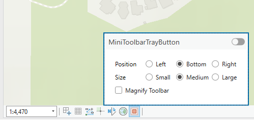

Map Tray Popup Button
The tray popup is a small popup window that opens when the mouse hovers over the tray button in the status bar. When clicked on, the tray button will still execute the code in OnButtonChecked(). The Tray Button SDK template includes a view and view model for developers to follow the recommended pattern for adding user interface controls to the tray popup window.
Step 1. Create a new map tray button.
Add a new ArcGIS Pro Add-ins | ArcGIS Pro Map Tray Button and name the item MiniToolbarTrayButton.cs. Change the ButtonType to PopupToggleButton in the Initialize method.

Step 5. Edit the view to create the user interface.
Open the file MiniToolbarTrayButtonPopupView.xaml to see the popup designer and template xaml code. Find the line <!--content--> and replace it with the code below. This is where the radio buttons to control the position and size of the mini toolbar will be defined. The new xaml creates a grid with 3 rows, the middle row is created for space. A second grid is added to row 1 of the first grid and will hold the radio buttons inside its rows. Also notice the IsChecked attribute of each control has a value with a name that describes what the control will do. We will use that name in the ViewModel to create a property to complete it's binding.
    <Grid Margin="20,20,20,20">
        <Grid.RowDefinitions>
          <RowDefinition Height="Auto" />
          <RowDefinition Height="10" />
        </Grid.RowDefinitions>
        <Grid Grid.Row="0">
          <Grid.ColumnDefinitions>
            <ColumnDefinition Width="60" SharedSizeGroup="Position"/>
            <ColumnDefinition Width="70" SharedSizeGroup="Position"/>
            <ColumnDefinition Width="Auto" SharedSizeGroup="Position"/>
          </Grid.ColumnDefinitions>
          <TextBlock Grid.Row="0" Grid.Column="0"
                             Text="Position"/>
          <RadioButton Grid.Row="0" Grid.Column="1" GroupName="ToolbarPosition"
                           IsChecked="{Binding IsToolbarLeft, Mode=TwoWay, UpdateSourceTrigger=PropertyChanged}"
                           Content="Left" />
          <RadioButton Grid.Row="0" Grid.Column="2" GroupName="ToolbarPosition"
                           IsChecked="{Binding IsToolbarBottom, Mode=TwoWay, UpdateSourceTrigger=PropertyChanged}"
                           Content="Bottom"/>
          <RadioButton Grid.Row="0" Grid.Column="3" GroupName="ToolbarPosition"
                           IsChecked="{Binding IsToolbarRight, Mode=TwoWay, UpdateSourceTrigger=PropertyChanged}"
                           Content="Right"/>
          <TextBlock Grid.Row="2" Grid.Column="0"
                             Text="Size"  />
          <RadioButton Grid.Row="2" Grid.Column="1" GroupName="ToolbarSize"
                           IsChecked="{Binding IsToolbarSmall, Mode=TwoWay, UpdateSourceTrigger=PropertyChanged}"
                           Content="Small"/>
          <RadioButton Grid.Row="2" Grid.Column="2" GroupName="ToolbarSize"
                           IsChecked="{Binding IsToolbarMedium, Mode=TwoWay, UpdateSourceTrigger=PropertyChanged}"
                           Content="Medium"/>
          <RadioButton Grid.Row="2" Grid.Column="3" GroupName="ToolbarSize"
                           IsChecked="{Binding IsToolbarLarge, Mode=TwoWay, UpdateSourceTrigger=PropertyChanged}"
                           Content="Large"/>
        </Grid>

Step 9. Build and test the Add-in.
Once the project builds successfully, open ArcGIS Pro and open a project with editable layers in the map. Verify there is a new button to the right of the zoom to full extent icon in the map view tray bar or if you didn't create the zoom to visible extent tray button it should be right next to the Corrections tray button.
*As noted above only 7 tray buttons will show up. So if it isn't visible make sure you have not added more tray buttons than the limit.
Toggling the tray button main toggle will make the editing mini toolbar no longer visible. Toggling it back on will make the toolbar visible again. Hovering over the tray button icon will open the popup. It should look like this:
With the toolbar toggled back on test out the checkboxes that control the position and size of the toolbar to verify it works.
